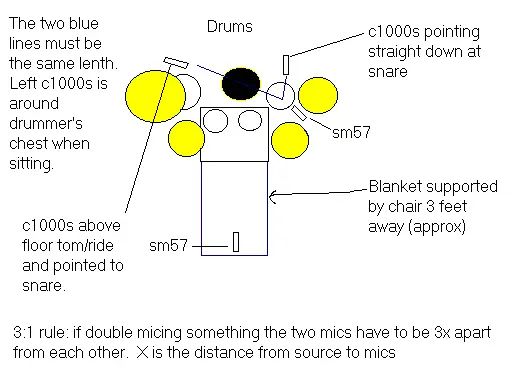

Would this be a good idea on how to set up my drums? Or would you recommend putting the mics behind the drummer?

This is a kind of cool debate.Do you want the sound to appear as if its coming from the drummer's perspective or the audience?No hard and fast rules here.I mic from the drummer's perspective behind the kit personally.

You could make him a lefty or righty that way.The placement of mics either in front or in back is more subtle.Most folks won't hear the difference anyway.

sounds good.
Do you think this would work with minimal phasing problems?

Sure,give her a shot and post a clip.Here is a clip of my band using 4 mics on the drums.Its sure not metal!But you can hear the drums.I used a pair of ecm8000s as overheads,with an SM57 on the snare and a V67 on kick.

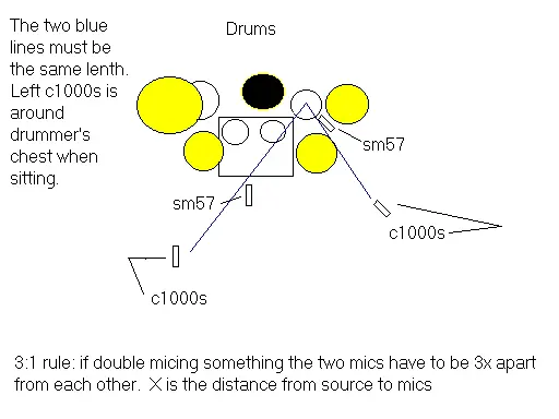

Is this picture kinda how you recorded yours? This is how I picture it

Excellant pic!I did it pretty much as you have noted,except I violated the 3:1 rule by having the overheads closer to each other than that guideline would suggest.I think it was the careful measuring of the overheads that kept phase problems at bay.My next time I record drums I play to try a much wider placement to see how that effects the stereo image.

I wasn't planning on following the 3:1 rule
as long as the overheads are same distance from the snare.
