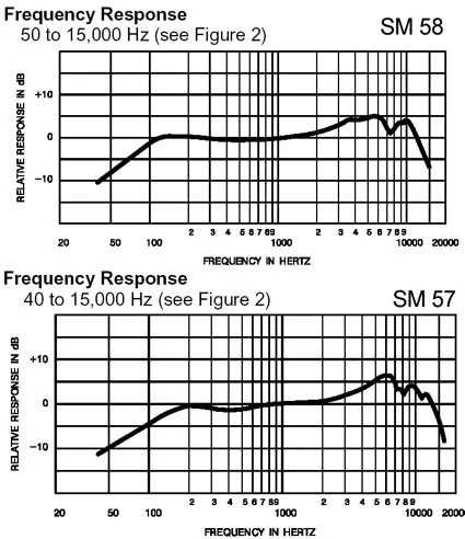

hmmm
In fact THERE IS a slight difference between them.
Is not as simple as "take the shield off" (1st time I disagree with the Big Blue Bear)...but maybe the difference is so subtle that it doesn't matter...
The SM57 has a frequency response that makes a low cut from 200Hz, while the SM58 goes down from 100Hz. It also has a slight boost in low freqs (SM58), because it was designed initially as a vocal mic, so they added that mini-boost to make singers more "comfortable" with the mic, as they would hear a richer sound. The SM57 was designed as an "all-purpose" so it has a kind of "flat" response, but it also has a better response in high freqs (what makes it more "sibilant" than the 58, therefore, not so good for live -not-controlled- vocals).
If u are not sure about it, go to sure's website and see the manuals.
Anyway, if you consider this differences as non-important, you will be receiving a NEW SM58 in trade for your OLD SM57...
Or you may want to have some different mic for vocals...there will be a small difference there...

See for yourself...
Check it out man...
Peace...
PC

Actually you aren't disagreeing with me at all... I said "essentially" in my post...
I know there's a "slight" difference -- I've compared both and I've always found the difference to be relatively inconsequential...

Hey...glad to know the Big Blue Guru is with me...
Yeah I know it's very VERY subtle, but I noticed it comes more notorious in recordings (than live), specially if it's a simple tune (guitar and vocals)...no kidding here...maybe I am imagining...possible...lol

Actually, in the context of a mix, there does appear to be an important difference between the two. Since the 57 is generally used on snare drum and guitar amps, one would think there would be the need for a bit more bass-cutting if you were to use a 58 for either of those chores in place of the 57. Otherwise, I could see where they might sound a little too full, and either could cause some clashing with the bass guitar.
200 khz is an ideal place to start rolling off for either of the two, which is where the 57 begins to tail off. That is one of the major reasons it is so popular for guitar and snare. The 200 khz rolloff just helps them to sit in the mix better, and thus requires less eq.

there are very small differences, but these are very small!
"poo" (hmm?), the best thing to do it to try the 58, if you can hear the difference you are making, and you like it, go for it. otherwise, there isn't a major reason why you should change microphones, apart from what someone said about exchanging an old SM for a new.
