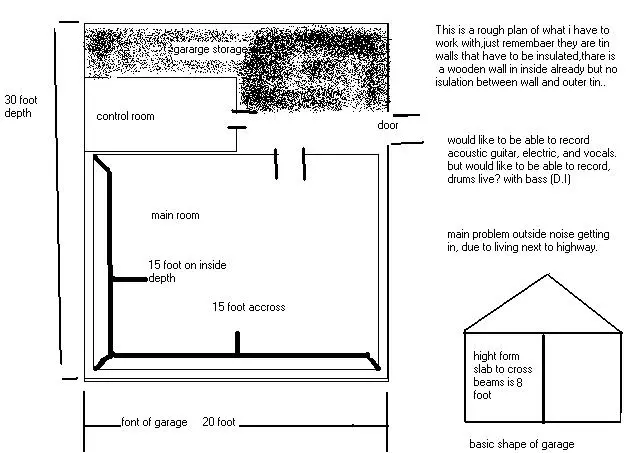

Can you post a drawing of the room, with meassurement? Have you checked the SAE/Sayers site? Lots of great construction tips.

this is a rough sketch of what i have got
thanks for the help, here is a the drawing of the size garage i have to work with.

I think your biggest problem is going to be the low freq. highway noise getting in. Room within a room will be the best option. Don't know if you've seen this: http://www.studiotips.com/front.html some good stuff there. Also check out this: http://www.acoustics101.com/ lot's more if you do a Google search on soundproofing. Just beware: there's a lot of B.S. out there too.
