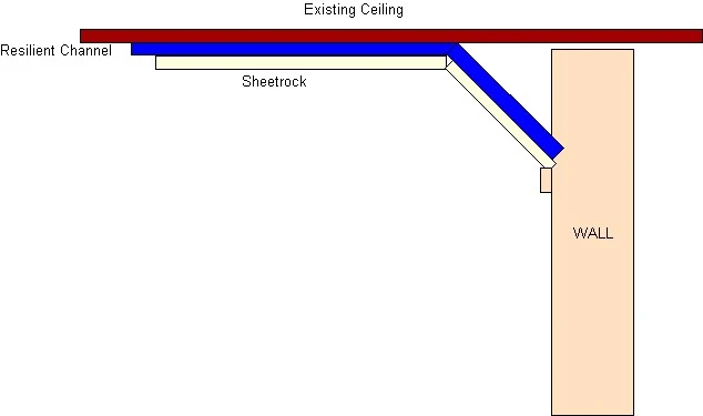

Executivos or John - in your experience using resilient channel, and I'm refering to the thicker 1" furring channel here, is it strong enough to hold up sheetrock at a 45deg angle between the ceiling and wall as shown in this drawing?
Thanks

longsoughtfor...In those corners, are there studs going along the gaps in the corners as well? It's VERY flimsy....
As far as plywood on resilient channel, I'm going out on a limb and saying it's probably not a good idea. Everything I've read says that plywood is not as good for isolation as sheetrock, and seeing as how sheets of plywood are like $15 and drywall is $5, I'd use the drywall.

Firstly the angled channel should be OK - hey it works horizontally
As far as the plywood verses sheetrock goes, I'd tend to go for both but thinner versions of each. i.e. sheetrock it in 1/2" then overlay it with 1/4" ply for the finish.

Okay I have pictures now....Here's resilient channeling....
