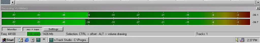

brand new behringer mixer...is IT broke - or am i? (PLEASE help..i'm gonna cry)
I just bought a BRAND NEW Beheringer Eurorack MX802A mixer.
I plug, from the 2 L/R main outs, then i got some adaptors on the end to make it into 1 1/8" stereo, and put that into "LINE OUT" (in my soundcard).
No matter what i try or do, the soundcard only reads the LEFT side. I've switched chords in every way possible, and still its always the left. I'm pretty sure its not the soundcard too - becasue it works if i use my old 4-track as a mixer.....
So i had to mix everything to mono before recording a band that came over today... so i guess it's the mixer, right? maybe the R "main out" is just broken..malfunction?
if anyone has any ideas, maybe i'm doing something wrong (i dont thikn so...) then PLEASE let me know.
Also, even with NOTHING plugged into the soundcard...it looks like this:
(see the attatched pic)

Look on your adapter plug, the one that goes converts to 1/8" plug, are you sure it has a stereo tip? Be very sure its not mono.
I agree with Tukkis on using the tape outs instead of main outs.
About the attached pic, thats your noise floor. Does your soundcard have a Line In jack? Maybe you should try that also.

good eye...but that was actually my typing error...lol I meant i bring the L/R line out (from the mixer) into the 1 1/8" plug (LINE IN) into the soundcard.
I'm gonna go ahead and try to use the "tape out" for now though...if that works...then i guess my mixer isn't broke after all.

YES!
Tukkis thanks TONS that line out in the tape out thing works perfect. thank god...ha
i'm glad it wasn't the mixer.
