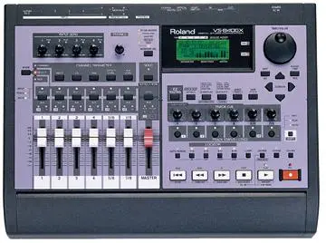

Hey. I am not too familiar with the machine. Is it the one that I have attached below? If so, you would do your mixing on the machine itself without an external mizer before you dumped it to the PC. Another question. Does that machine have digital outs? I read something that it did, but might be mistaken. If so then you can get digital (Optical) in sound card and you would be in business. If there are no individual track outs, then the only way you are going to be able to use the machine is as a dump unit. You won't be able to use it as a computer interface unless you can record one track at a time, dump it down to PC and somehow sync the next one that you record. Something like an ADAT has 8 innputs and 8 individual outputs (one for each track). This allows you to send each track out of the machine istead of only all of the tracks to a stereo out. Also, they have an optical output that allows you to send all 8 outs through 1 light-pipe or fiber optic cable, and by using software in the PC, you can keep them all separate for mixing on the PC. Your machine seems much like a digital or hard disk 4 or 8 track that is all self contained. I think it was designed to record and mix, then dump to cassette or CD via an external device. Give me some more info on how it is used if I have missed something.
Fangar

THATS MY DOG (THE ATTACHMENT I MEAN). IT DOES HAVE DIGITAL OUTS-FIBER OPTIC & COAXIAL. SO IT SOUNDS LIKE IF I GRAB A PROGRAM (SOMETHIN LIKE CAKEWALK), A GOOD SOUNDCARD WITH FIBER 'IN' , AND A FIBER TO HOOK IT ALL TOGETHER, I'M IN BUSINESS. RECORDING, MIXING, AND BURNING!
