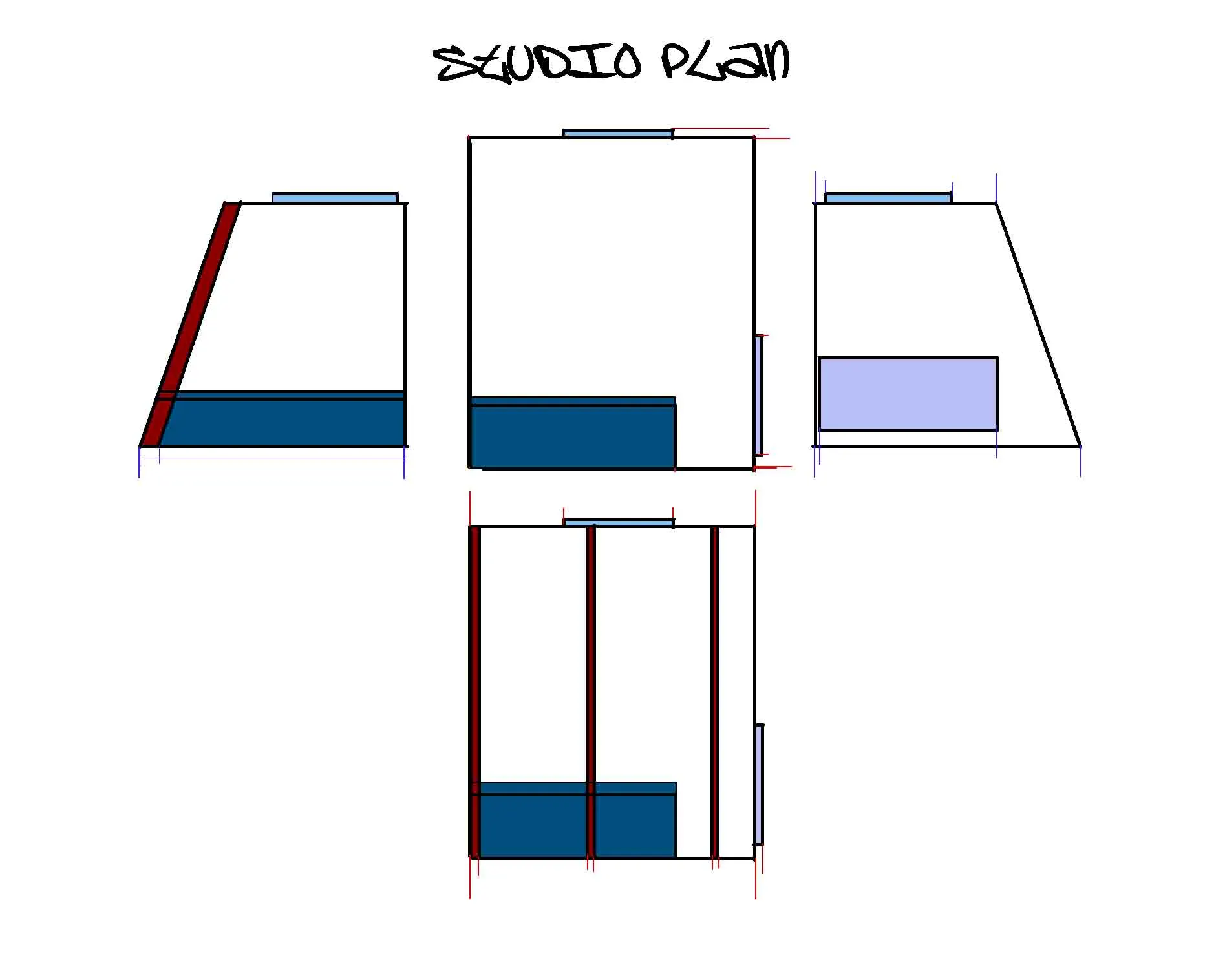

I really need some help as to what i can do with this room. At the moment i'm looking to get a decent vocals booth kinda thing happening in here ASAP using as little time and money [or maybe just a lil more time if need be (to save money of course)] as possible. Please look at the pictures i have put up especially for this thread here -----> http://www.krym.s5.com/photo.html <---- and either post some sugestions as to what you'd do to overcome the problems i'm facing, or you could email me at kymc@arcom.com.au or krym@krym.s5.com. The sooner i get some help, the sooner i'll be able to get down to murdering this c1.

Firstly you can seal the joins with a standard polyfiller (comes in tubes and you apply with a squeeze gun, ask your local hardware). The ceiling is in fact the best part as you can fill in between the rafters with insulation and cover with cloth.
could you give us a floorplan??

Also thanks heaps John, i will get down to drawing up a flaw plan straight away, how detailed are we talking here though?

I haven't put the measurements in yet, but are these the ones you would want to know before i either over kill or under kill?

Measurments are very much needed. Also lable the views so we know whats what.
All we need is a floorplan and an elevation view showing the angle of the celing and the heigh of the walls.

Measurments in Cm M? or Ft and Inches?

Thumbs up Studio plans with measurements [in cm.]
I hope this isn't too confusing.
Thanks again.

KRYM,
That pic is HUGE. It won't even fit on my 20" monitor.
Can you shrink it down so the whole thing can be seen at once?
