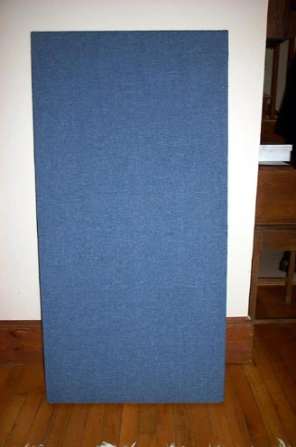

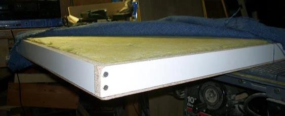

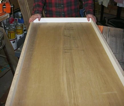

I built some simple sound absorbers today for my friend's guitar teaching room. (It was loud with too much room echo) Got some pics some of you might enjoy as I know pics speak volumes when making your own.
Materials
1-4'x8' sheet of 1/4" luan board
1-16" x 96" MDF board, 3/4" thick
1- 4x8 sheet Knauf 2" fiberboard
2" drywall screws- for frame
1" drywall screws- for luan back
4 yards of blue upolstery fabric- (similar to a burlap weave)
3/8" staples
We built 4, 2'x4" panels.
Specs on the fiberboard will knock down 500hz to 5k and reduced amounts off either end of these numbers.
Basically we built trays with the MDF and luan, and dropped inthe fiberboard, wrapped it in cloth and stapled it to the back. They look really good and clean. the lines are actually better than they look inthe final photo...
He plans to hang some from the ceiling using eye hooks and wire to lower the freq response, and also put them on the walls.

panel components

finished pic

correction we built 4, 2 foot x 4 FOOT panels!

I got a deal on the fiberboard, and total materials were about 50.00 USD. Had I paid full price for the fiberboard I think it would have been another $10.00.
So, $12.50 a panel, $1.56 sq foot- not bad.
The 2" auralex I've previously bought was about $16.00 a panel. Buying auralex or a similar product would be easier but obviously there are applications where studio foam is not the desired look...

As a follow up, I haven't actually made it into my bud's space since he put them up, but he reported to me that just 2 panels really improved his 10'x 6' teaching room. Where he used to be bothered by ear fatigue from a loud room he now has to speak a little louder, because the room markedly deader sounding.
I gotta build about 36 of these in the next weeks, we'll see how the mass production goes... will post any alterations I may come up with in the process.

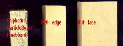

What's MDF board?

Hopefully the attached pic will help answer that. MDF is much denser than chipboard/particleboard/pineboard, whichever you wish to call it.

Thanks, Aus. i thought it was an abbreviation for something.

Medium Density Fibreboard

And the best part about using MDF is that unlike plywood or pine board, MDF cuts and stays straight and true. makes for nice lines.
