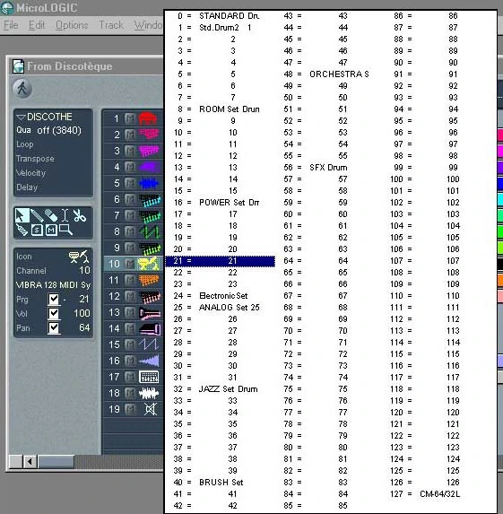

Hi all,
I hope you can help me with this problem as its driving me up the wall! I have a Creative Vibra sound card. Here's my problem, no matter what sequencer i go into, I can for example go to MIDI chanell no 4 (or whatever chanell) and change it to any of the other 127 MIDI instruments. Now heres the problem: if I go to the 'Drum' chanell (usually assigned to number 10) and select another drum sound for example, 'Jazz Set Drum' or 'SFX Drum' or any of the other 127 drum sounds, it simply will not change to the new drum sound I have selected. It seems that it is defaulting to the one drum sound. What can I do? Is this a MIDI conflict or somthing to do with my sound card?
Any ideas will be greatfully appreciated...
Thanks, buzzmeeks

Hi Guys,
Again thanks for your patience in trying to help out here. Im using MicroLogic Fun. When I say that it is defaulting to to the same drum sound, I mean that it continues to play the same drum kit. I have attached a screen shot to show how I would select another 'Drum Kit' but it ignores if I select another kit and just seems to play a default kit even if the channel name has changed to a kit I selected eg, 'Electronic' or 'Jazz set'. If you guys could figure out how I can access any of the other 'drum kits' (which you can see in the screen shot) you would be saving my sanity!
Thanks a million, Buzz
