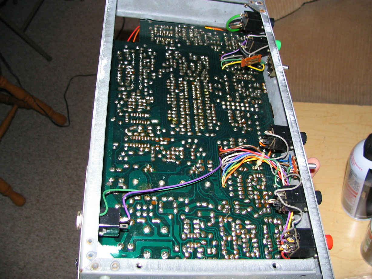

It was always a pretty tired looking box even from the time I got it...clearly had spent time on the road and likely on the top of a guitar amp...lots of scratches, dings, nicks, scrapes, rust...rubber feet gone, level switches busted, that sort of thing, but its always worked. Its been one of those little projects in the back of my mind to recap it and clean it up. So I took part of an evening and did just that.

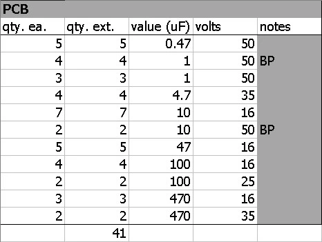

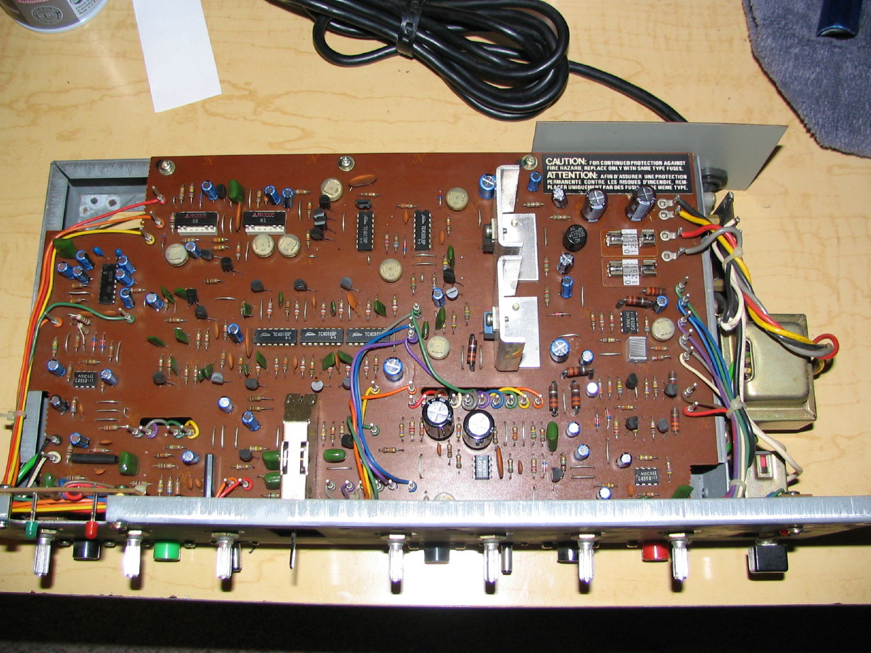

Here it is opened up before any work. Recapping was a little hairy for me because there are no symbols or screening on the PCB so I had to be extra mindful of paying attention to the orientation of the polar capacitors. I haven't done an audio test yet but nothing blew up when I plugged it in and powered it up so I'm hoping I got them all in right.

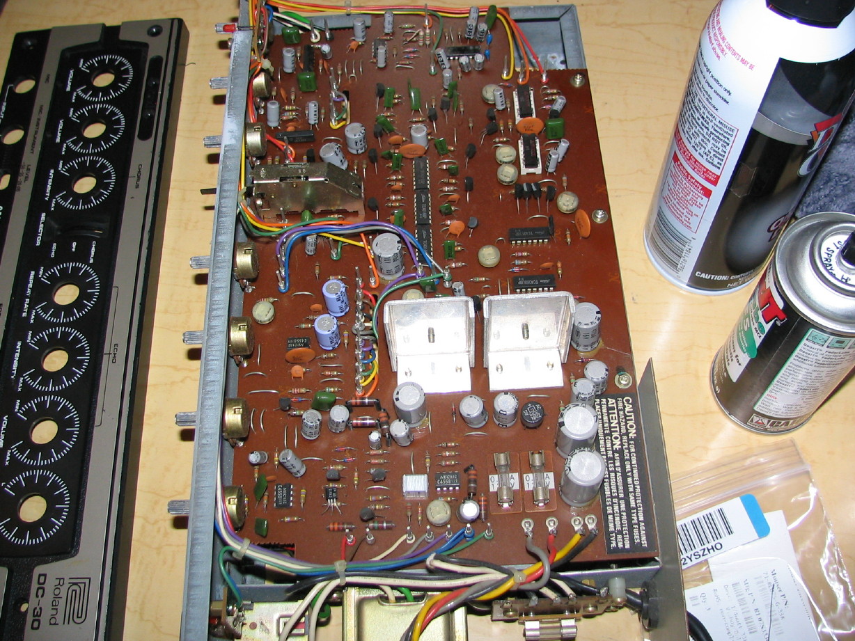

Here it is with the new caps in it:

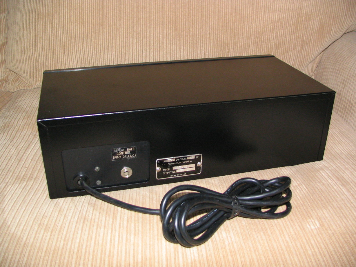

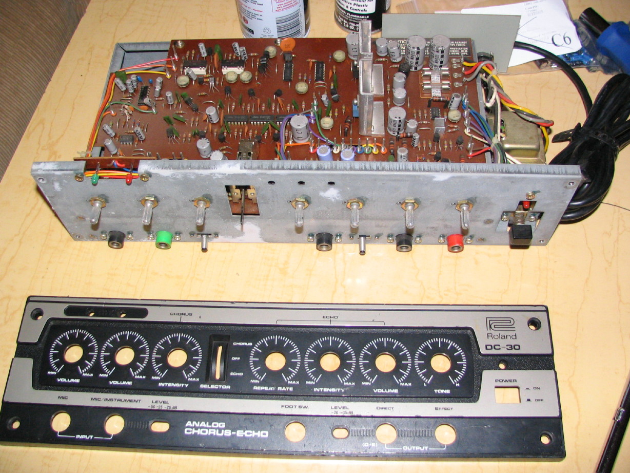

I did all the usual stuff to it (cleaned everything well in and out, applied DeoxIT to pots and switches), but also repaired the level switches, found some replacement feet for it and repainted the case. I have a little touch-up to do on the dress panel yet, and it'll always be a little rough looking, but it was a worthwhile few hours spent on this unique analog effects box that will most certainly remain in my collection.
I'll put up a couple pics of the finished project soon.

The promised pics...
Refurb finished, unit reassembled.
