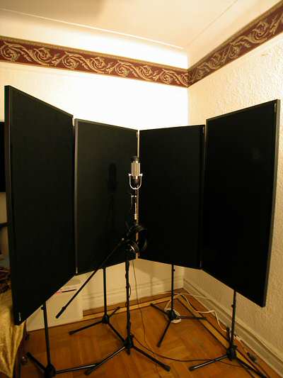

There's a lot more that goes into it than just the dimensions... Properly treated, small rooms can sound fine. Poorly treated, large rooms can sound terrible. Here's a photo of Nick Lachey's home studio - his vocal booth is 4'x6':
If you can't fit comfortably in the closet area, I'd probably ditch the construction idea and opt instead for making a couple of gobo's that you could take with you when you move. You can buy these pre-made from Real Traps www.realtraps.com or you could fabricate your own:
It just doesn't seem worth the effort, frustration, and unknown sound results to build something on the scale you're describing, only to tear it down within a year and start over. That money could be much better spent on things that you can maintain and reuse over the long term. I know it doesn't look as cool, but nobody listening to your CD cares what your recording space looked like.
Very true and also.. Im aware of those types of portable recording items that you can move and stuff. When we are recording also I keep the monitors on on the outside of the booth to make sure The artist inside is staying on beat etc. So a wall-less structure is a no no. Plus I wont need a booth in a year. Or any of my own equipment. Long story short. Im moving to LA already connected. Im on probation here thats why i cant move from chicago for another 10 months. All I need is 10-15 properly recorded tracks and I should be fine. ***Not tooting my own horn or bragging about anything***. Just letting you know why the portable is useless to me and my team right now (and very pricey as ive seen)They have everything down there in LA already. : )
That was a GREAT idea though especially since you knew I would be destroying it in the future! thumbs up for that idea!!!
Thanks for the post! Any other input aside from the portable? : )

Well, since you seem to be interested in what people have to say, I will throw out some ideas...
You could modify your closet, add to the existing structure by widening the door, and making an addition to it. I dont have access to your pics at work, but it would be a decent fix.
To avoid having to build a room at all you could get isolation headphones and and instead build a box for your computer and recording equipment (anything that makes noise) and close the lid on the box during recording.
You could set up 2 very heavy blankets in the corner of your room, have them overlapping in the middle (about 2 feet overlapping) with the mic 1 foot from the blankets. You will be singing into a corner with this set up.
You could record in the room, and move your equipment into the closet, while only closing the door during the recordings so you dont run the risk of overheating your equipment. You would only need your CPU in there since your monitor doesnt make noise, and your keyboard wont make noise, and your mouse wont make noise. Just turn off your speakers before recording so you aren't pumping in white noise to the room during a recording.
BAsically there are hundreds of ways to get a decent recording in a small room without having to spend very much money. You want it to look somewhat professional, so you could get some MDF and build feet for them so they will stand up tall. You could cover the MDF with your foam, and just make 2 of the standing partitions so you can turn them into a "V" and sing into them. They will look nice, and they will be easily removed when you leave. Heck, you could probably sell them to someone in your city for $100 when you leave. Just be sure to build them so they will stand over time.
These are the most realistic ideas for you. Building a seperate room is not inexpensive at all. I built 1 wall, and installed a door in my basement - It cost me more than $500 after it was all said and done. You have to take into account cost of all the supplies. And believe me, there are more than $500 in supplies in building a booth. 4 walls and a ceiling.
