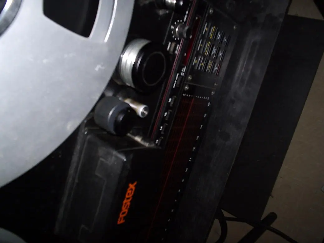

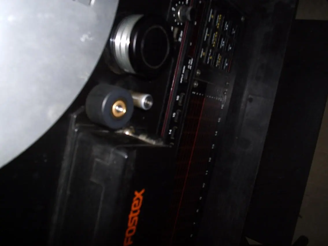

Here is the pinch roller.
I have a link to buy a new roller, but its in Japan, and it may not be the cause of my problem.

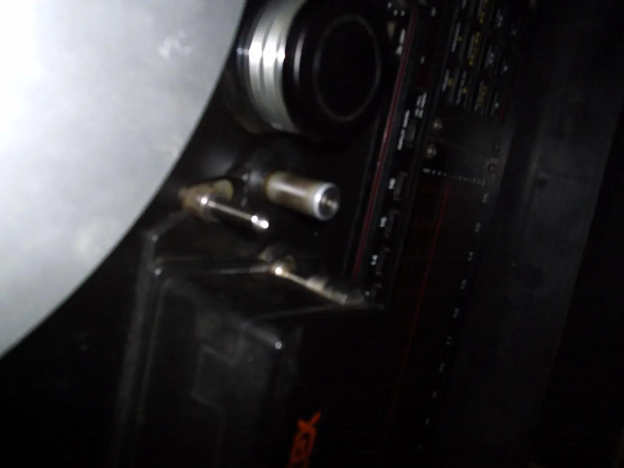

Ok...the front of the machine.
In this pic, I have drawn on where the drive belt runs, behind the facia.
If you press play, the motor runs the untoothed belt, and turns the pulley with the capstan on it. the pinch roller closes on to it, which should pull the tape through, and it does, but on playback, there are massive speed and therefore pitch fluctuations.
If I hold the capstan or the motor pully, the motor slows down and struggles to speed up again. if you give the capstan a quick twist, it will speed up again. If you hold the roller so that you stop it from turning, it will not start again, until you give it a twist.
To me, in my admittedly unexperienced opinion, this seem like a weak motor.
if the motor was strong, surely, if i held the capstan, it would make the drive belt slip.

Some pinch rollers have roller bearings in them, many don't and just have a bronze bushing like you have there so your pinch roller looks fine.
In one of the pictures the pinch roller looks shiny, like its glazed. Is it hard and slick, or is it nice firm grippy rubber?
Is the belt tacky at all? Hard/checked/glossy or is it firm grippy rubber?

Arrow The pinch roller looks hard and slick.
That doesn't bode well for the belt, either.
I'd say, replace the belt and try to recondition the surface of the roller with rubber reconditioner.
Your problem description does not sound like a motor problem. The rubber drive components are usually the things to fail.

I cant check the belt at the moment, because ive built it all back up, so i didnt lose any of the bits.
The pinch roller is a bit shiny, I wouldnt say it was as grippy as, say, a bike brake block. Its certainly not new rubber feeling, but then again its a bit subjective....im not experienced enough to know its suitability, and the only way ill find out, is waiting for the shops to open in japan, as they are closed till the 10th apparently....

The pinch roller should be matte in appearance and should feel firm but grippy to your fingers. If it is shiny and smooth it needs to be replaced regardless of your current problem. That's my 2p. It is hardened and glazed.
If it were me I'd be replacing the capstan belt and pinch roller since the latter should be done anyway and if the pinch roller rubber is at that state the capstan belt is suspect too...then if that doesn't help the problem you're no further behind since those two parts should be replaced at this point anyway IMHO.

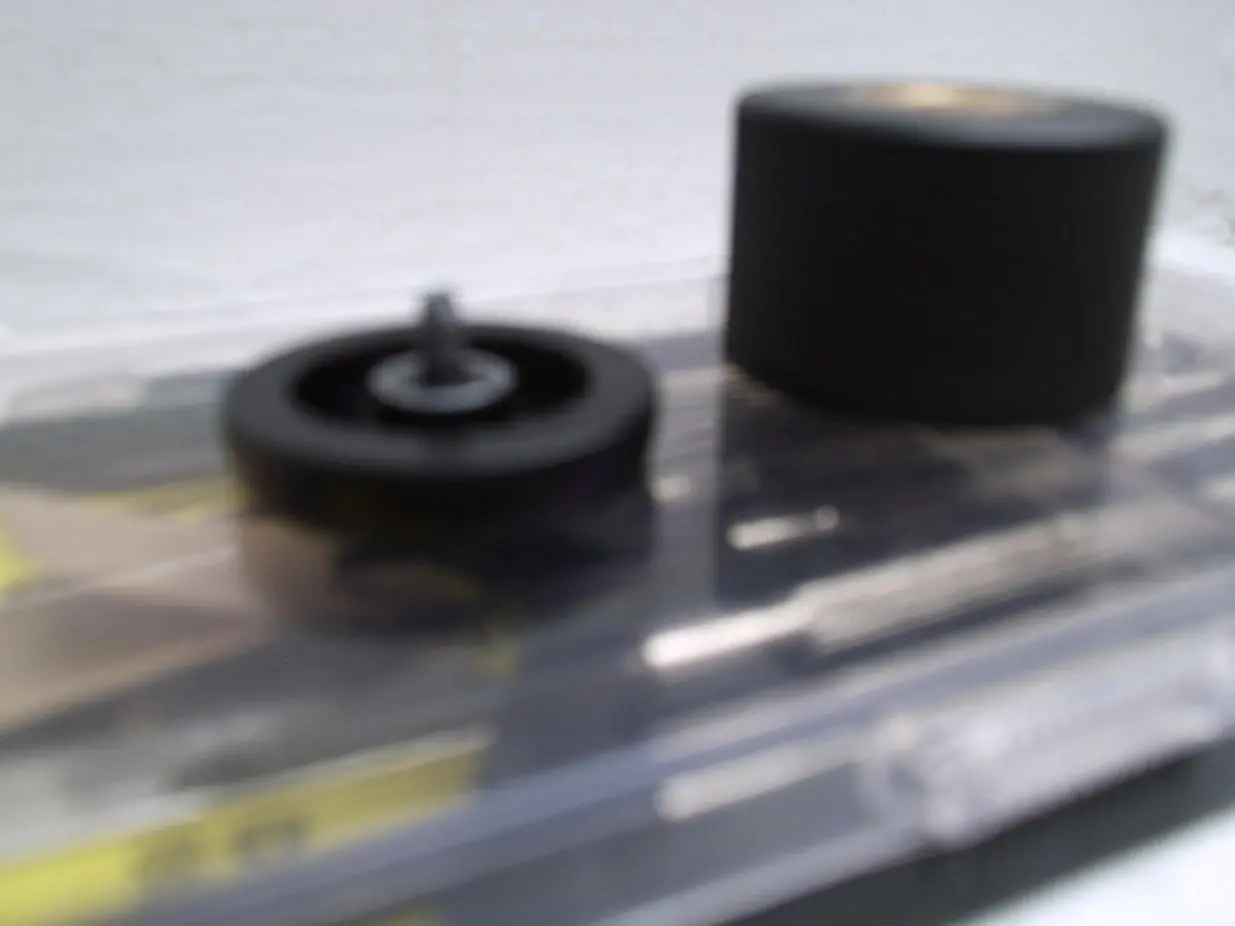

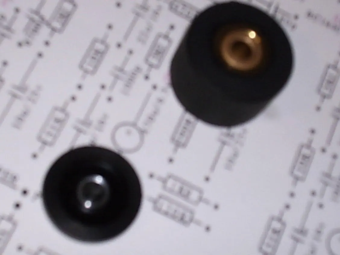

The pinch roller looks similar to my Fostex E-16, I'll attach a picture to this post for the experts here to look at, I have cleaned it usually with a very small bit of soap & slightly warm water using a cotton head cleaning swab stick.
There's no ball bearings on mine, the outer plastic cap just screws in to connect the roller onto the Fostex, my old Fostex A8 had the same roller cap which was a silver colour

Mr Fruit, does your R8 have a screw cap for the roller like the picture I've attached in my previous post?
It look's like it needs this for the pinch roller & capstan to work properly & all the R8 google image pictures I've seen have them on.
If you don't have one of these caps on your pinch roller it might explain some of your problems?

No, it doesnt have the outer cap on the pinch roller, it doesnt have any thread on the shaft to "screw" one on, although it has a groove which looks like it may take a small circlip. if you check out the thread in the first post, it shows pics of 2 R8's, one with the black cover, and one without.

here you go trancendental...

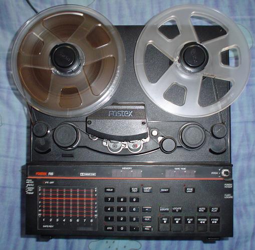

mine looks like this (not mine)
rather than this:

The cap is actually metal not plastic & it has a built in screw attachment that screws into the pinch roller. The cap with attached screw keeps the pinch roller in place.
If the cap is not fitted the pinch roller will move about I would presume, because there's nothing to keep it in place once the tape starts running at speed?
The screw caps are the same exact type as on the larger tape rollers, they should unscrew & watch out for the springs!!!!!
I've taken another (bad fuzzy) picture to show the exact details
EDIT The Cap Screw cover screws to the pinch roller spindle even without the pinch roller fitted. As I mentioned earlier all the Fostex machines have similar setups, from the A8 / B16 onwards & your R8 is just a later MIDI featured version of the M-80 / E-8 so very similar to my E-16.
Screw size diameter at the base appears to be 2.5mm length is around 4mm according to my calliper, you might be able to use a screw (not bolt) with a large pan / button / round / truss head wider than the pinch roller hole
I would contact the seller to see if they have the cap screw cover?

Im not sure if im understanding you, But I think I am....there is no thread on the pinch roller shaft at all, for anything, just a indented slot for what i presume is a circlip....ill take a pic to show you.
I agree in principle with your logic though, I just dont see HOW i could attach a cap.
I cant contact the seller, I bought it from Ebay over a year ago, its been stored while I got my studio room ready.
heres the end of the pinch roller shaft.

From your picture, its obvious that your cap wouldnt screw into my existing pinch shaft, so unless its been replaced, Ive got to presume:
1-They changed the design to some sort of circlip retaining clip
2-My pinch roller shaft and mech, has at some point been replaced.
