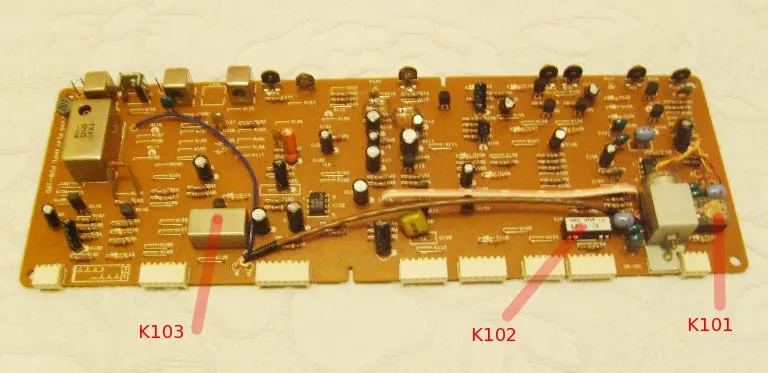

I'm attaching (I hope) a picture of the audio card. Each one has three relays, and the part IDs are silkscreened onto the PCB:
K101 - Switches between the Sync head and the Repro head
K102 - Mute relay
K103 - Activates the record head
K101 is the one I'd suspect - if it was on the blink it might explain your symptoms.

Here's the PCB:

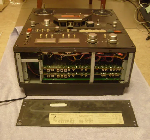

At first I thought you were saying you couldn't locate them, so I took this photo of my '32. Having done that I don't want to waste it so I'll post it anyway ;-)
By the looks of it you have to remove a supporting bar (which looks like it'll need the back off the machine too). It's probably a matter of hooking something into the holes at the corners of the audio cards and pulling, but since that may damage it if it's done wrong, probably best to wait for someone who's done this before.

Its similar to a 48 with which I'm familiar...jpmorris is on the right track.
Here's how I would do it:
  1. Remove the rear dress panel...that's 7 screws I believe, 3 down each side and one top center as you look at the back.
  2. Now with the rear panel removed you should see a screw at the very bottom near the center of the back. That's the rear of the card retainer bar...remove that screw.
  3. Now put the rear panel back on so you can safely lay the deck on its back. Probably don't need to put all the screws in. Use your best judgement.
  4. Lay the deck on its back:
  5. Now remove the bottom feet and the card cover panel (the bottom panel of the deck...should just be 2 screws left to remove to do this after the feet are removed)
  6. Now that the bottom panel is off and you can see the cards, you can see that there is one more screw that holds the card retainer in. Remove that screw and the bar.
  7. Now you should be able to remove the cards. They may be stubborn depending on the age of the deck and the environment in which it has lived but if they are stubborn gently rock them as you pull...not up and down, but pulling slightly harder on the right and then on the left...rocking that way. Jpmorris is right about the holes in the extreme right and left of the cards...they are for a card pulling tool which we all have laying around right??? Right. I use those holes as extra grip for the thumb and forefinger of each hand. Worst-case scenario you can fashion a piece of stout coat hanger wire into a puller but you shouldn't need to do that...just keep gently working them and they'll come out.

Kudos to jpmorris for the pics and detail from his 32. That should really help.
Its funny that with the number of 38's in operation out there we often seem to run up against a search for service manual docs on the thing...I have a full 32 manual and a 34 operations manual but nothing on the 38.
Awesome, I reseated the cards last night and same problems persisted, but I am going to do it again with the directions you gave me and let you know what happens. Thanks for such detailed instructions, very helpful!

Similar thread. Check those relays.
http://homerecording.com/bbs/showthread.php?t=280420

Yes. I concur.
I also concur with jpmorris that K101 should be #1 on the suspect list, and if your cards are like the one in the picture there is no cover to desolder...just pop that plastic lid off and gently clean away. If that doesn't do it then go for K103. K102 is solid state so nothing you can do with that except replace if that proves to be faulty, but it doesn't appear that its function would cause your troubles to occur.
alright i went in last night and checked out the relays (K101). I think that maybe my machine might be a slightly newer model or something, because there's no way to get inside and clean this part, its a solid black plastic box (labeled K101 so i know its the right part) and it looks different than in JP's photo, and the model number is off by a couple digits. I took one of them off of the circuit board and if there's any way to get inside I just don't know how. So, I'm guessing I just have to replace these parts? i keep forgetting my camera at the studio, i'll post a picture of the component.

Do take a pic. I've got a spare 58/MS-16 channel card that's got a relay like that that is solid orange. I believe that's a good thing tho'...I believe that's a non-mechanical relay which avoids these issues...huh!
Take a pic. Put it up.
What about K103?
And have you tried just cleaning contacts and reseating cards already and that didn't so the trick?
