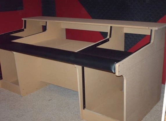

Here is the $1190.00 desk minus the finish. It is what I imagine mine to resemble when complete. I would just like to have a bit more room from the front edge of the desk to where the mixer begins, because I would like to center the keyboard on the desk if I can. If not that is fine too.

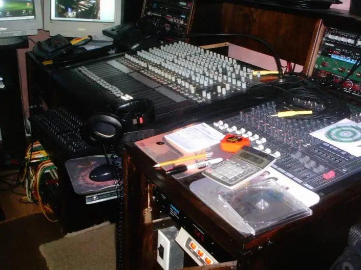

If you have the ability to make a nice looking desk, it would also seem you could just use items like that picture for your designs. Come up with some designs you like or even copy something that already exists.
I built something for myself very similar, but instead I put a sliding shelf underneath for the keyboard and didn't clutter up the mixer fadar area.
you gotta excuse the mess...I was taking a break reading forums...but back to tracking!

I know these pics don't show dimensions and stuff too well, but hopefully you get the idea. Here's another angle. Cost about $100 to make in wood, stain, varnish, etc. I made it "mahogany" colored to match the rest of my furniture in the room. I think the lighter colors if done with GOOD finish work would look great...or even in black.

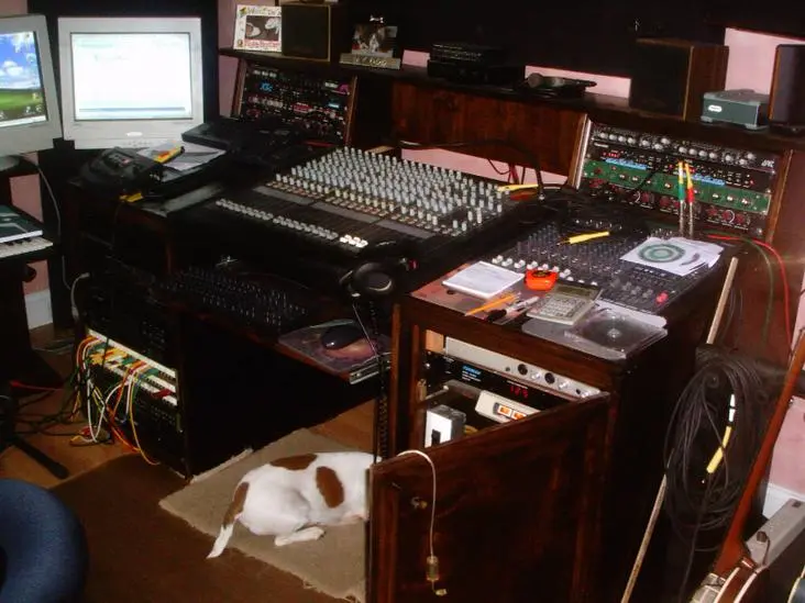

Honestly, in your pic, I see 4 "side" pieces that are just held together with regular rectangular shapes. Use brackets to hold things together if needed. What makes you pic look nice is the light wood contrast to the dark black and vinyl padding. Also, the side pieces DO have a nice shape to them. But just create one and use it for th template for the others. But look closely at the edges. You can see the "plywood" effect on those side pieces. But to the casual eye, you'll never really notice that.

Small detail, but one thing I really like about mixmkr's desk is the door on one of "pedestals." I could see one lining the inside of that pedestal with foam and putting the computer in there to keep the noise down in the control room. This is a common design feature of a number of Middle Atlantic and Argosy designs.

thanks David. If you notice you'll happen to see a USB cable hanging over the door for things I hot/swap out. Wadda suppose is in there???

I'd like to take the oppurtunity to point out that an enclosure on a pedestal with a door on the front and foam, etc *read* MAY cause heat issues with your PC. I suggest you use this tactic wisely.
An alternative to the door (which is the way I went) was actually monitoring the db level on the fans chosen for my PC case and lining every bare inch of metal inside my pc with "sound dampening matting" from frozen CPU. I've got a 120mm and 2 40mm as well as the CPU fan inside. The case sits at the bottom of my rack to the left of my desk and I have to look at the front to see if the light is flashing to even tell if it's on.
