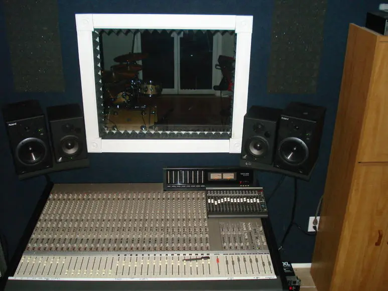

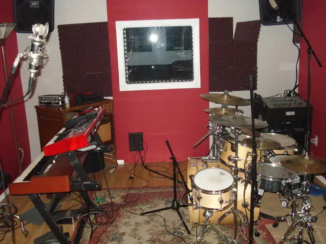

I closed in a doorway... framed the inside of the door frame with 2"x6"s and used 2 pieces of regular 1/2" glass... Put about a 20 degree angle on the performance room side for deflection... the sound transmission is almost NONE..
