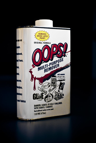

I've posted about cleaning belt gunk off in the past, but finding those posts with the search feature… I dunno.
Anyway, I use acetone or a product called OOPS Multi-Purpose Remover to get old belt residue off the capstan flywheel and motor pulley… works like a charm. I’ve also used OOPS to get stickers and stubborn Velcro backing residue off of mixing consoles. It’s stronger and faster than Goo-Gone, but doesn’t harm the paint at all.

Stinks like the dickens though!

awesome! Thanks guys. I gave isopropyl alcohol a go and it worked fine for the bits I got on my mouse and keyboard but for the thick layers of rubber that were left, I had to get out the steel wool and scrub the tar (pardon the pun) out of the capstan.
I'll have to get some Oops! (love the packaging!) for future worn out capstan belts.
