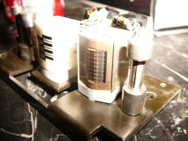

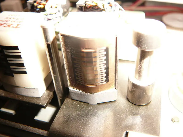

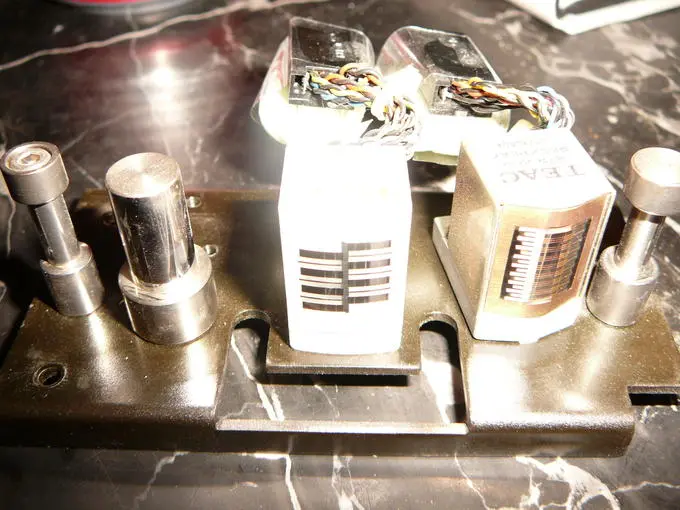

Finally got my camera back. Here are a couple of shots of the heads. Do you think I could benefit from a relapping from JRF magnetics?

Photo trick - Put a white piece of paper where you can see it reflected in the shiney parts of the head. this will make it easier to see the heads.
That looks like a bit of a keystone to me. Do you see any of the heads gaps? You might be able to see a fine line (which is the head gap). I'm asking about larger gaps.
I think I would be looking for a lower hours head to replace this one... It is not that this one is bad but rather that after lapping it there would be fewer good hours left in it. If you were to send it off to JRF you wold like your money to go a long way.
The erase head looks fine from the photos.
Here are you options as I see it:
1) Live with it as it is
2) Live with it while you look for a newer head then either keep the new head or send it off to JRF for relapping and alignment.
3) send it off to JRF for relapping
Tell you what, send your headstack to me and I'll relap your head and do some minor alignment. You will have to to the Az alignment and calibration.
This way if you have any life left in the head you can be operating while you look for a newer head.
PM me if this interests you.
Regards, Ethan

Yeah Ive looked at them closely and I dont see any gaps in the tracks. I do actually know what you are talking about.
What I dont understand is why do they call it relapping if all they are really doing is sand it smooth. To me relapping would imply adding some material to the head. So all that is making a head bad is the unevenness of the wear then right?
You would think that you would get better and longer life from a head if you ONLY aligned it. Otherwise you are just accelerating the wear out of the head.
Am I right or way off base?

You definitely have wear. You might try running a reel of 1/2" paper leader in play mode a time or 2 as a quick 'n dirty/temporary fix. It's been known to work. Before doing anything, make certain that it is a head issue and not wear and tear on the edges of the tape(s) being used. Checking the current head alignment is also a good idea.
Can you please broadened/expanded on this paper leader technique? Sounds interesting. What's it about?

You simply get a reel of paper leader and play it from one end to the other. It won't fix severe wear but can polish out minor irregularities. If you do it, I'd advise setting azimuth on the heads beforehand.
Have you tried a new, non Ampex/Quantegy reel of tape to verify that it's head wear and not defective/worn tape?
