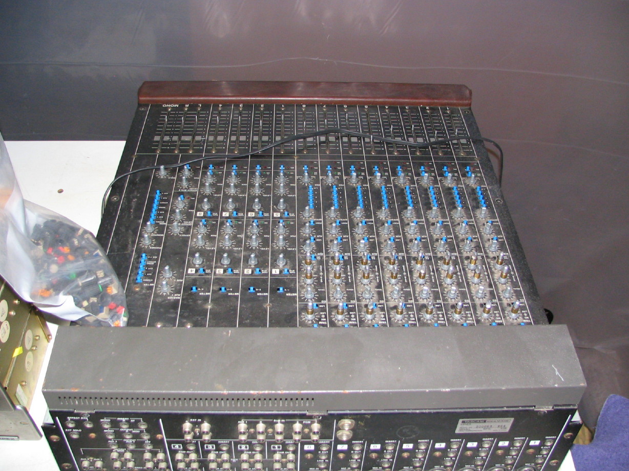

So I got to the seller's place and it...was...rough. Guys, its been neglected. Its got white paint overspray on it...no sidepanels...it looks like it has spent some time in a humid storage environment. I'm okay if any of you want to call me foolish. I couldn't leave it there...is that stupid? I didn't feel right leaving it in that uncaring environment...maybe I'm sick...some people feel that way about puppies at the animal shelter...so I didn't even try to talk him down price-wise. I gave him the $50, tucked the 308B under my arm and left.

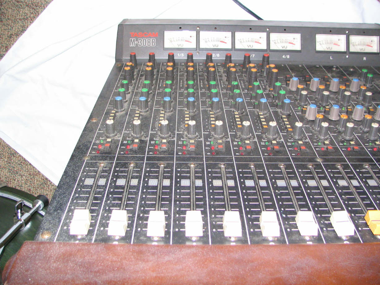

Overview:
All the lights light up except for the VU meters, and I do know it passes audio at least on channels 7 & 8. I'll test more thoroughly later:
But it is, by my standards, filthy...

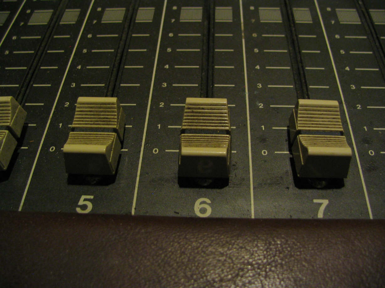

Cruddy fader caps for example:

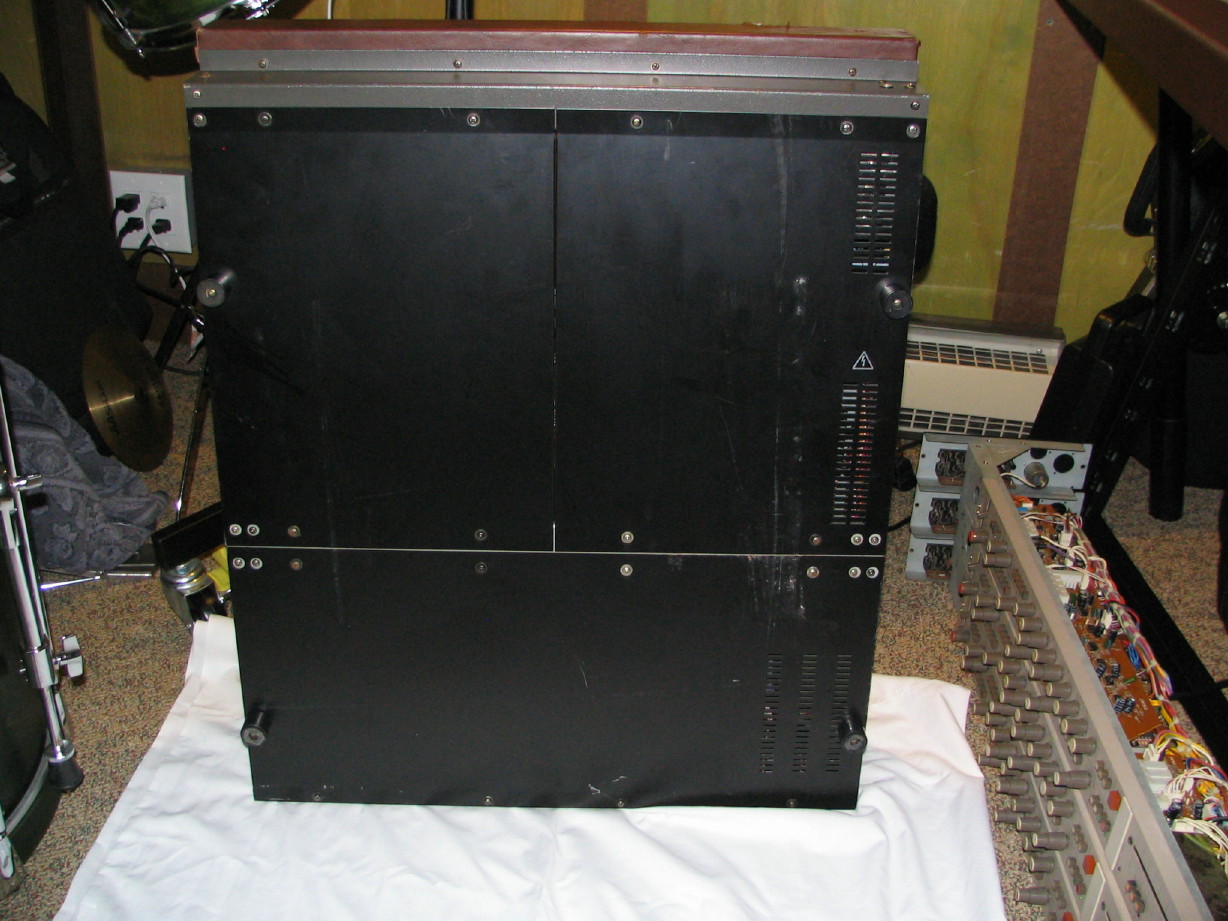

Bottom:

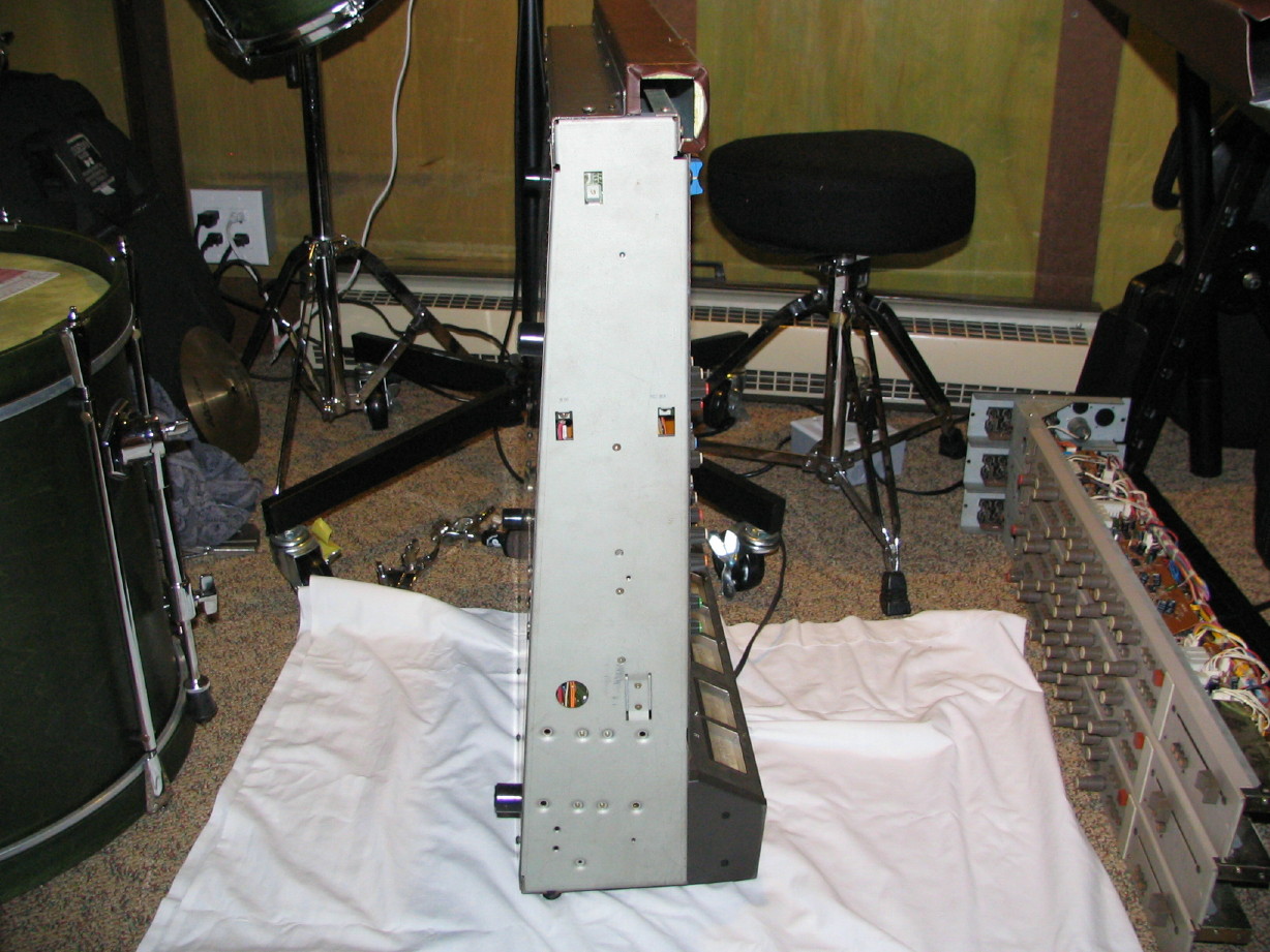

Side:

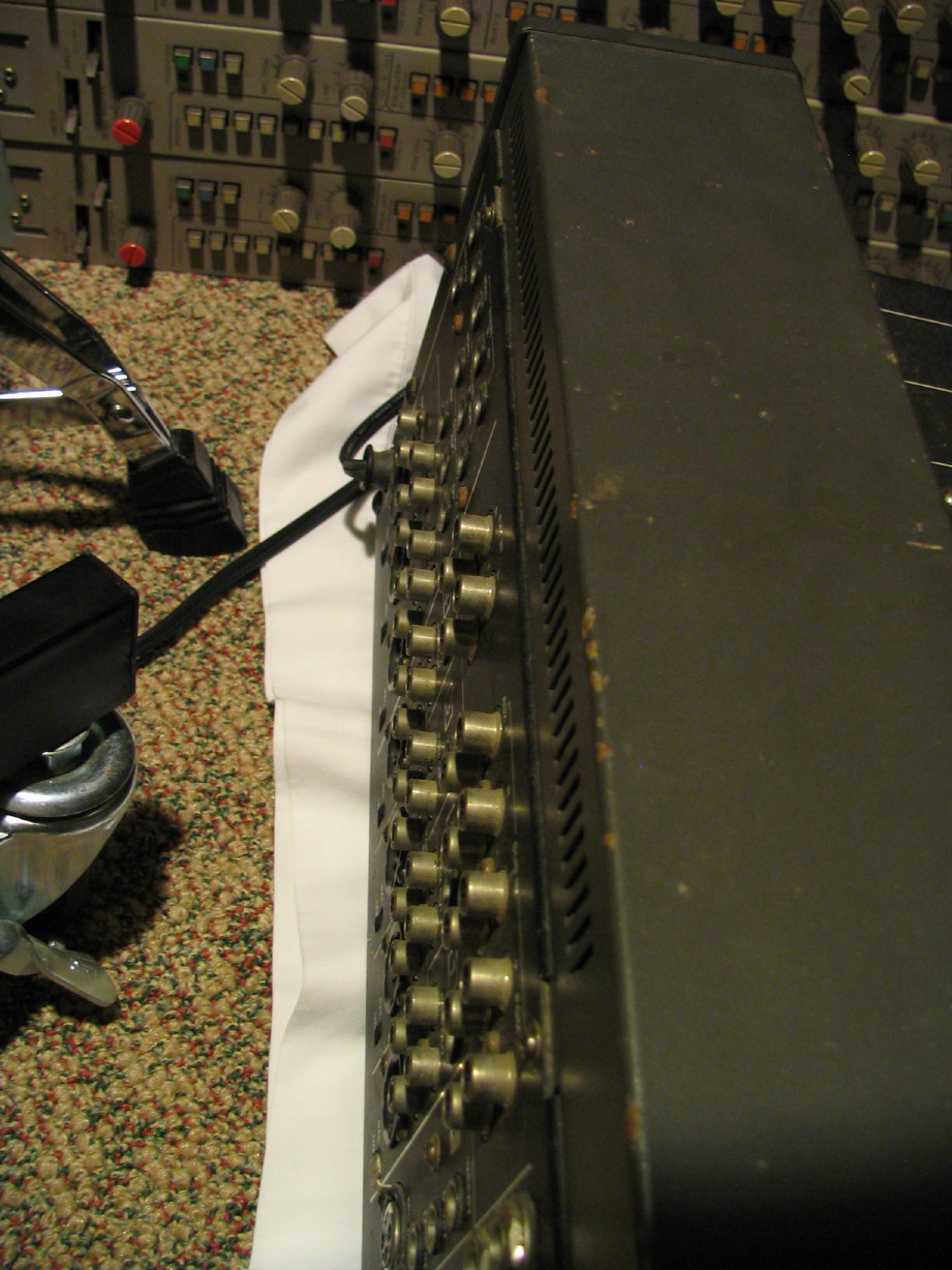

Rear (its not tweaked...the camera lens is makin' it look that way):

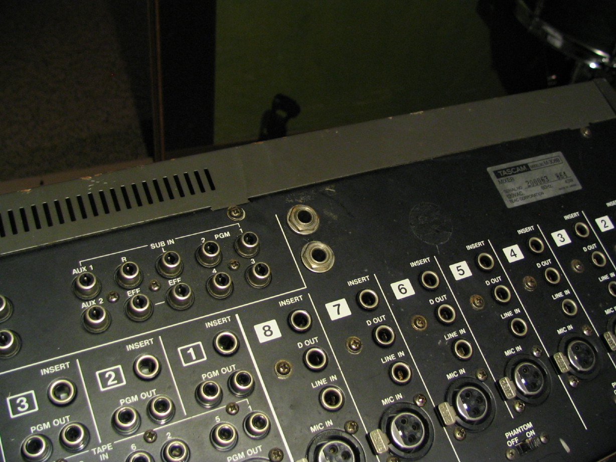

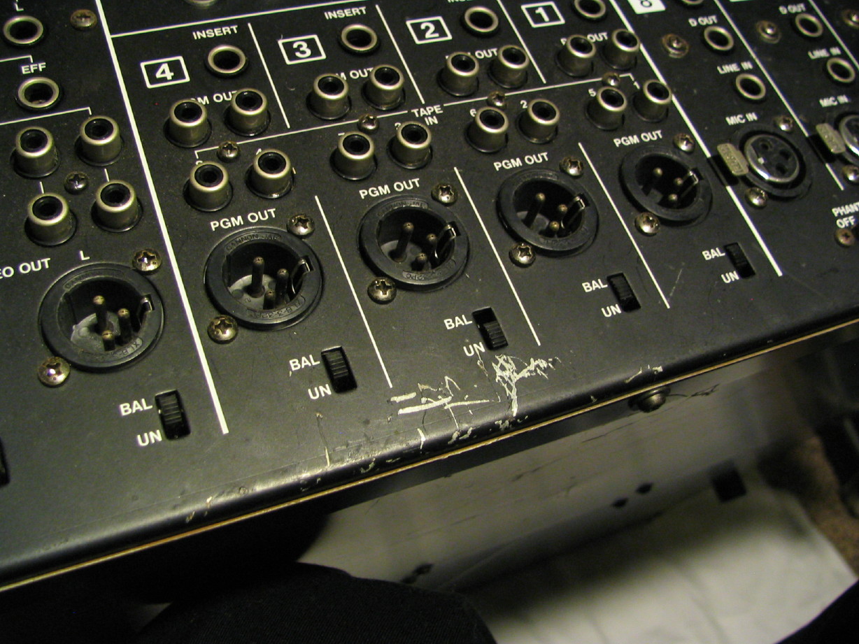

And zooming in on the jack panel...
Some healthy scratches:
And lookit the mystery jacks over the channel 7 jacks...?

I just noticed something...!
The blue knobs in the monitor section, the two rows of 4...they don't belong there...
The 312 and 320 have aux sends in the monitor section but not the 308...should just be the level and pan knobs...
I'm gonna go out and see if it looks like the dress panel got drilled for those and they are a mod...

Just a guess, but maybe those extra knobs feed the two out of place 1/4" jacks on the back. Possibly another aux feed to do a second mix to studio headsets????

And the extra knobs appear to be different style.

Another board with "mystery" jacks? Maybe it's the M-____ access points!
Remember, the Tape-In routes thru the 1/4" Line-In jacks, but don't ask me why,... I've still not figured out the practicality of that design. I'm still of mind that Tascam was going on-the-cheap with that design, just trying to used "shared" circuitry. To me, it's a caveat.

Naw, they're the same...they do look different somehow in the overview shots, but if you look at the pic that's a closeup of the dress panel (showing the rust) you can see one of those blue knobs...

Right-right-right...thanks for that reminder. I had forgotten that whole bit and was trying to figure out the tape access point...I figgered it was the LINE input jacks, but hadn't tested it yet...gotta get ahold of a manual...I guess you could see that as a cost-cutting measure...so the M30 and M35 have separate LINE inputs on the channel strip and TAPE IN jacks that patch direct to the monitor section? Yeah...I can see that would be nice...so that's where a patchbay would come in handy with the 308.

Yeah...the blue mystery knobs on mine are definitely non-stock, but whoever added them did a nice job on drilling the holes, and the pots were soldered into the group channel PCB's where the AUX 3 & 4 pots would be on a 312 or 320...dunno yet what they feed...I'll find out though. I'm wondering if the feed the mystery jacks...maybe those jacks are AUX 3 & 4 outs sans master, but that wouldn't make sense bacause they'd be lacking the amp stages of those masters...anyway, to be determined...

On second thought you are half-right about those mystery knobs being different...taking a closer look tonight under better lighting they are totally the same style but a slightly lighter shade of brown...supports the notion that they were added some time after the mixer was manufactured.

Just a little side-trip
Took a few minutes to pull the knob and switch caps off...this is what it looks like today:
Its funny...that picture makes it look like a really small mixer...
Anyway, I was messing with it in response to a question in another thread...answered a question I've had about how to get to the meter lamps since mine don't work. Here's the post for those that want to know:

Cory, I admire your dedication to the cause...
I think this little Tascam looks like a well resolved unit for this size/format of mixer. It would make a cool little sidecar to use alongside the M-___. Hell, for 50 bucks this thing is worth it for all the Tascam spare parts alone, let alone the fact that it's a functioning desk. Hmmm.... I could picture it with some cool custom side panels... or maybe integrated into some sort of desk on roller wheels with rack spaces underneath...
Also, the cool thing about a desk that is a bit rough 'round the edges is that you can play around with alterations/modifications without feeling too bad (is it just me who always feels a bit guilty modifying something that is minty and original?). Just something to think about...

Already got the side panels thanks to a goods in trade deal with evm1024...he made up, like, three sets of beautiful mahogany panels when he needed a set for his 312B.
The plan for this mixer is to get it cleaned up, probably recap it or at least the PSU and use it with the 234 or possibly even the 58 if the Ampex 8 track ends up with the M-___.
It'd be a great mixer to learn on. My youngest son likes to operate the mixer and recorder functions on my dad's 424 mkII. I kind of had it in mind that the 308B would be a good step up. He's really interested in it. He saw it for the first time the other day and now he won't stop asking if its ready yet. Even when he was a baby he loved plugging and unplugging cables.
So that's the idea...not that I see the 308B as some sort of Fisher Price My First Mixing Board or anything...just that my kids are conscientous and this 308B will never be minty anyway, but I don't have a primary need for it but it could be great for the kids and I to use together.
Again, like I've said before, the 300-series mixers are really amazing feature-wise and in their construction...a quality item. I can't fathom why somebody would go out and spend more for a new mixer and get less features and lower quality. I'm sure it is the tinker factor, but as far as small mixers go this thing is a goldmine.
