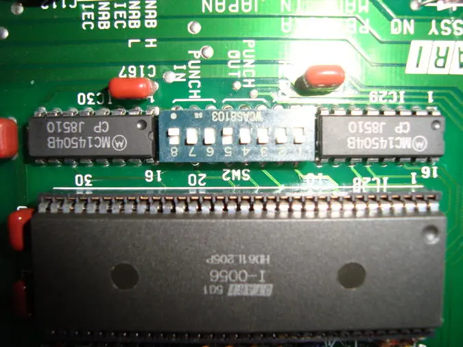

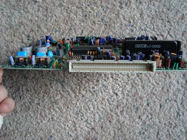

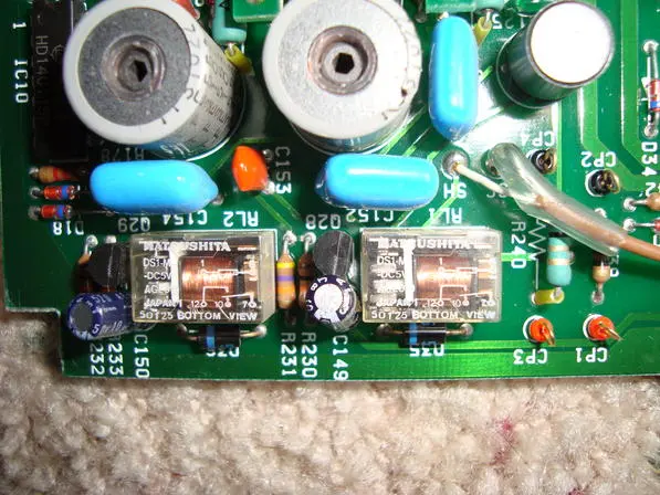

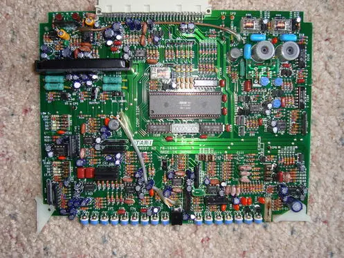

Ok. The playback works fine but the record signal goes up and down and there is crackling. I don't think its the relays. Here's a couple of pics:

Couple other things you might want to try that Beck suggested to me when I was having trouble:
  1. Since I saw your post about DeoxIT, I know you are looking into that. Get some and apply the DeoxIT cleaner to the card connector pins, seat and reseat the card a couple three times.
  2. Ensure there are no cold or broken solder joints where the card connector socket is soldered to the card (a bajillion times...). You can ensure this by reheating those joints and sometimes even adding a little solder as you go.
I was having the exact same symptoms with my Tascam 58...it was driving me nuts...repro levels all over the place all the way down to nothing. I cleaned the relays, cleaned the connector and reseated several times and rejuvinated the carad connector solder joints and the level problems were totally gone and the switching from sync to repro to input were crisp and quick.
Good luck. Get that DeoxIT.
Anybody ever gone to the extent to apply DeoxIT to the trim pots on an amp card? That is going to extremes I suppose but that's another thing that I've always wondered about for these kinds of issues...I imagine those little trimmer pots are prone to the same issues that arise with regular trim/gain/pan pots and such...
