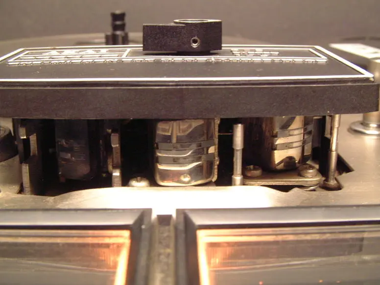

Could be two things:
# cam-assembly on the playlever is broken and the tape-lifter will not engage properly, or:
# Adjust the small rod next to the record head in the picture ( second from the left) suppose to be straight and push the tape away from the heads in fforward + rewind.
