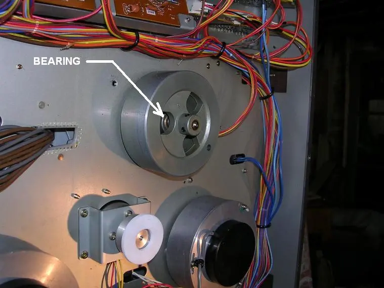

Maybe he means the main flywheel bearing? (see pic) Rock the flywheel gently side to side then up and down, if you see/feel some "slop" maybe the bearing's worn. A REAL SMALL amount of play should be OK. I guessed wrong about the bracket having a bearing on it for the shaft, the dimple in the middle must be for clearance.

Yeah I hope the motor is ok- the previous owner had wrapped masking tape around the flywheel to allow using a smaller belt!
So i measured the play on the flywheel and it was quite a bit-maybe an eighth inch front to back.
I loosened the set screws on the collar and pushing the shaft gently from the other side took out most of the play. I retightened the set screws and spun the flywheel by hand. I believe manual suggests .1 to .3mm. if i'm reading it correctly.
It spun true ( to the eye ) quiet, and went a long time.
So possibly i dont need a new bearing?
When i spun the capstain motor wheel ( the white one equidistant between
the motors) on the other hand, it seemed to have some wobble. Maybe not a problem because it is under direct load?
