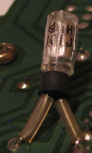

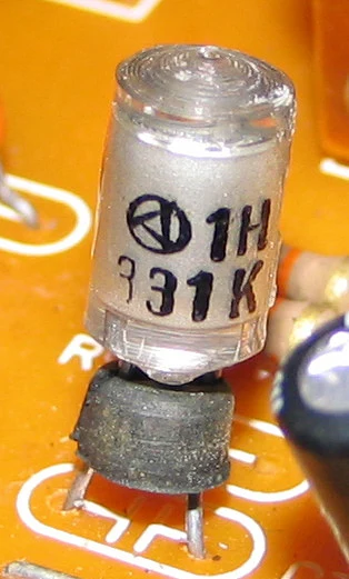

Question Can somebody help me identify these caps?
The first one is labeled "1H 331K". The second is labeled "1H 101J"
I want to replace them.
How do I determine capacitance and voltage rating on these things, and what kind of cap are they??

polystyrene 330 pf and 100 pf
Very nice for audio - perhaps the best sounding.
331 = 33 * 10^1
101 = 10 * 10^1
102 would be 10 * 10^2 or 1000pf
http://www.elecraft.com/Apps/caps.htm
Polystyrene caps are easily messed up by solvents and heat...No acetone or long time with the soldering iron.

So is there no voltage standard for these, and why?
And am I correct that this would be a suitable replacement for the 100pF cap?

Sure those poly caps would work. You might want to consider Wima polypro caps or mouser.com offers polystyrene.
How many do you need? Surplus Gizmos has polystyrene inhouse....
