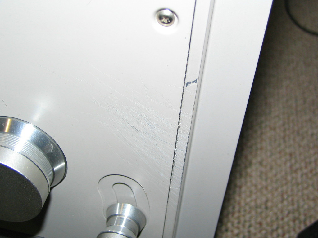

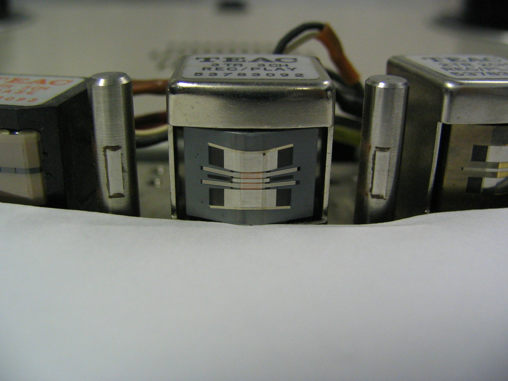

Looks like there is a spot on the right-hand side of the face that had 80-grit dragged across it , the top feet on the back are busted off, there are some screws missing on the front and back panels, and the VU's don't light. Other than those mentions it appears to be in good condition and things spin as they should and when they should.

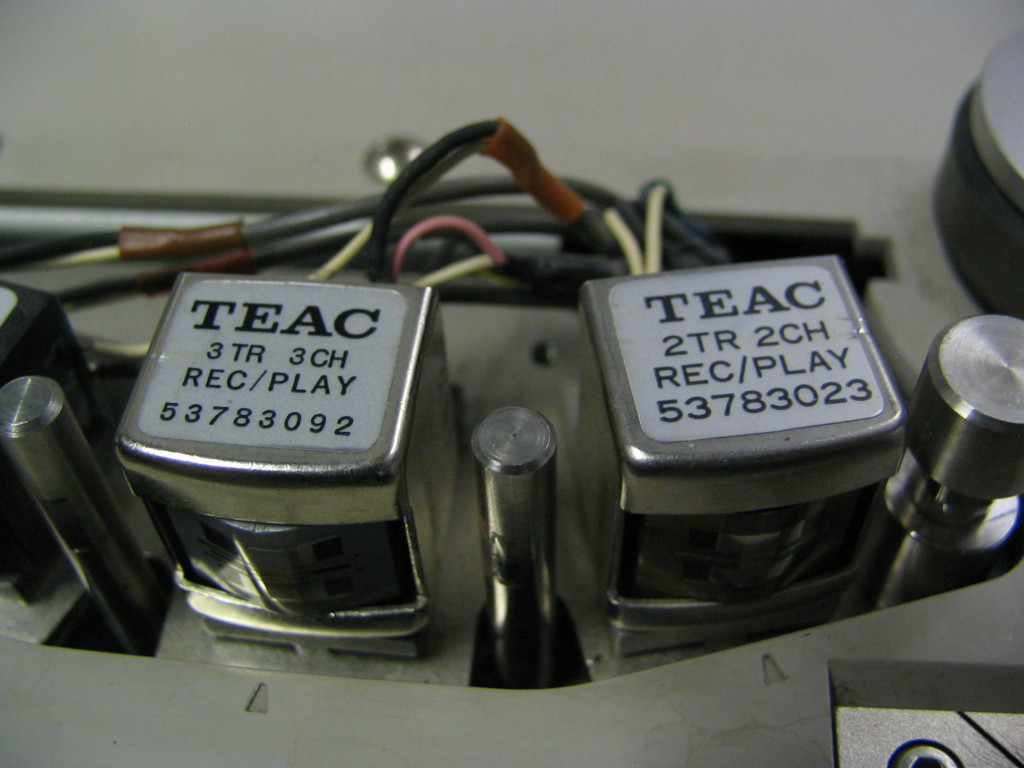

I guess my one main concern is that the heads show some wear. I've been spoiled by the condition of the heads on my 48 and 58. It wouldn't be a concern except that I'm certain the heads for the BR-20T (the 3-track heads) can't be cheap or common.
So did I goof?
Here's the 3-track sync head:
Here's the repro head:
Here's another shot of both the sync and repro heads from a different angle:

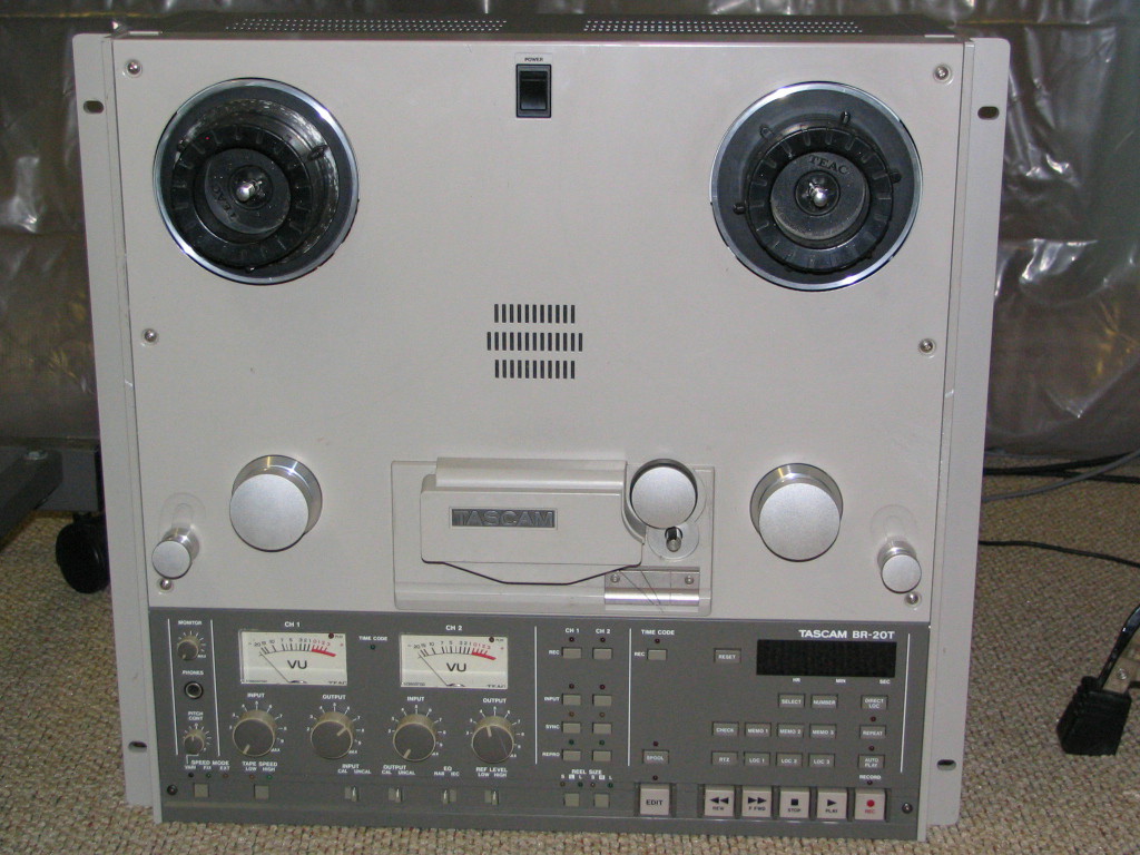

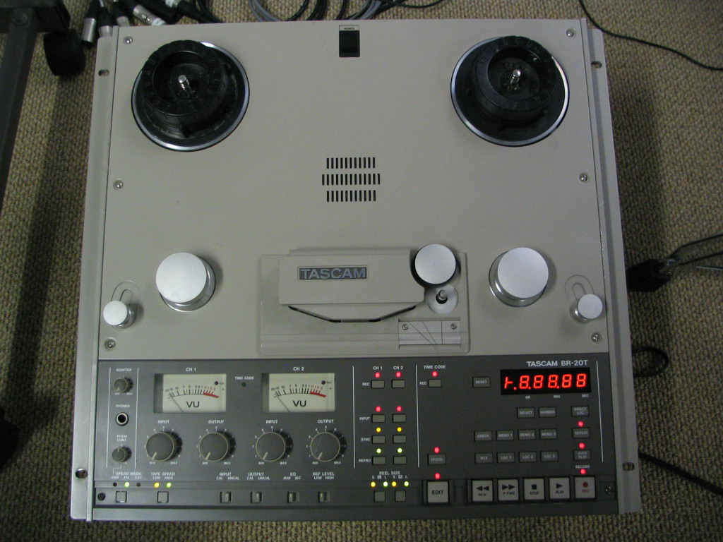

The front panel:
The front panel with pretty lights (except no VU's):

Those scratches I mentioned above:

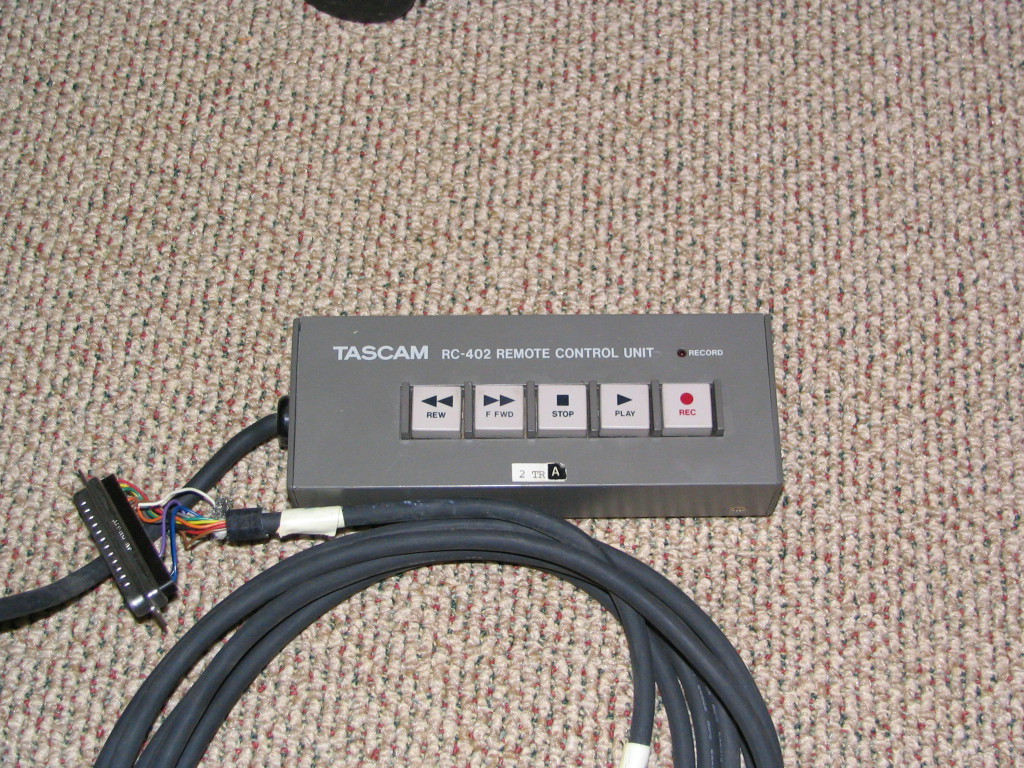

The remote:

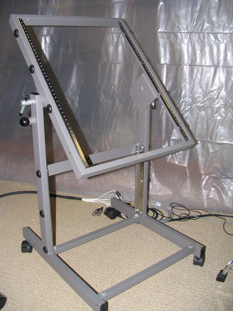

And the cool rack stand (which was never assembled correctly...at present the locking pin can't do its job because the plate with the holes is on the wrong side . Anyway, its 14U up top and 7U down below:

The 3-track heads - last I saw - were more expensive, but they were available. If not, a regular set of BR-20N heads would work if you don't absolutely need the timecode.

Cory, while obviously not as low ware as your 48 / 58, the heads on that BR20 look reasonable. I may want to align it to compensate for the ware but I think it should spec out nicely. I think it was a reasonable deal and the heads can be had rather cheap new, taken out of a low millage 32 or lapped but I wouldn't do that just yet. Clean the tape path and see how it sounds. Wouldn't surprise me if it was still within spec.

Just the rack and the remote alone are probably worth a couple hundred. I'd say you still got a deal. If you can't find lamps, they're sometimes hard to order or take a while to get (unless you know where to get them) I'd try salvation army or a yard sale for old electronics with VU lamps in them. Good chance you'll find something that will work with it.

The relapped heads may actually perform better than new since they'd be optically aligned as a set by JRF Magnetics, but, like brakes on a car, there's only so many times you can turn them before there is too much gone (or lap them).

OK, looks like the BR-20N and 32 share the same heads. The cost is only about $70 new. Cory, I would be surprised if you couldn't retrofit your 20T with 20N heads. I'd check with TASCAM on that.

http://www.openreel.net/parts_2.html has a head list... It shows the BR20N as 53783018-00 at 9600 yen ($95) and the 32-2B as a 53783010-00 at the same price.
Ah, Looking further I see that the 32 uses the same heads ...
http://www.openreel.net/headlist.html
I'm looking at my BR-20N and see that it indeed does use 53783018-00 heads.
The Din version of the BR-20 heads cost 28,200 yen.....
They list a belt but who knows if available.

Hm...
The BR-20 manual indicates that the sync and repro head part numbers are both unique from both the 20N and 20D models...
The 3-track head isn't listed in the openreel.net parts list, and the "proper" repro head is 21900 yen.

They usually put 'on back order' or 'discontinued', if not available, so I'm pretty sure they have the belt for the BR-20. I ordered a bunch of stuff from that place and they always had in stock as indicated on their site. It's worth checking out.
Also the BR-20N / 32 heads are 6900 yen which is 69USD, based on xe.com
Again, why couldn't you fit the regular BR-20 heads into the 20T? I bet it could be done, may be worth exploring that area and it'd be much cheaper.
That'd work for the repro head, but I do want the timecode track on the sync head...
BTW, heard back from Tascam on the capstan belts and they have them in stock for $10.37.

Ordered tape today (two pancakes of SM900...planning on going sans noise reduction when using this deck and I figured the extra headroom may come in handy, andthe SM900 was actually cheaper than the SM911......by about $5.)
Also ordered an MRL tape...21J203...multi-frequency 15ips IEC.
Once I have those stuffs I can (at some point ) get the BR-20T into spec (hopefully) and start doing things with it.
