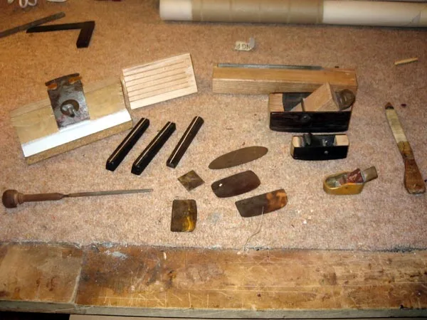

OK, I've had a quick route around my bench and all these tools I've had for years are all used regulaly and none cost more than a few coppers. They can all be made in less than a hour each sometimes minutes. I have thousands of others but these I had to hand.
I'll post a breif description of each next.

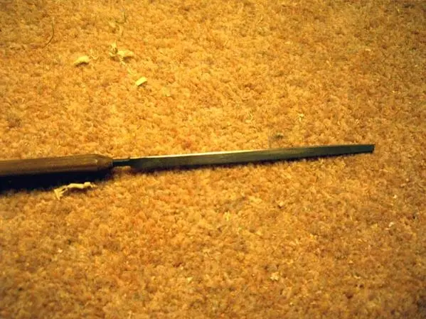

First some helpful fretting tools. You can buy these and I have them shop bought ones. These work just as well. Sorry about the picture quality by the way I only have a cheap camera with me.
Triangular fret file. For rounding off sharp fret ends and shaping them. You don't want any marks on the fingerboard or binding while doing this. Take a fine cut small triangular file and mount it in a comfortable and light handle. Grind off the edge to a small bullnose and polish.

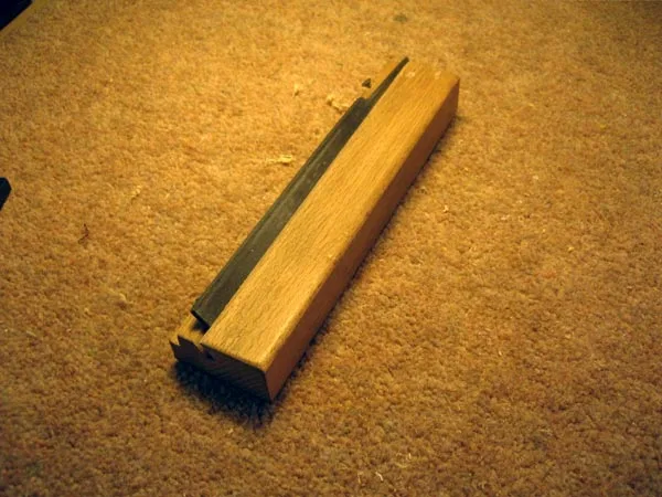

Angled file block for fret bevelling.
To file a regular and even angle on the fret ends after refrets or fretting.
This just a block that holds a file at 45 degrees to the fingerboard. Fine cut again and is used to slowly angle the frets to the finished angle. This one is actually a little steeper than 45 degrees because thats how I like it. Made from beech and about 8 inch long.

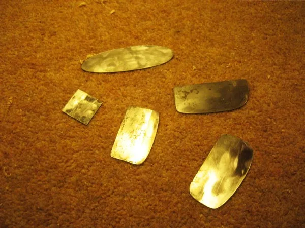

You can never have enough cabinet scrapers. These are all cut from old saw blades and are different sizes and thicknesses. I have hundreds in all shapes and sizes. I rarely use sandpaper until I start doing the finishing. All cleaning is finishing is done with scrapers.

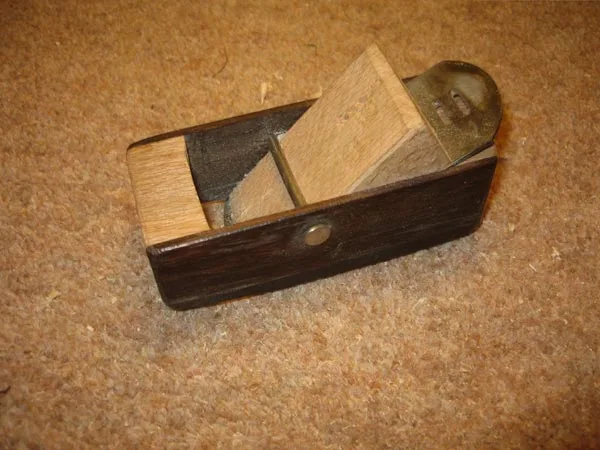

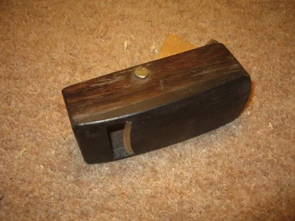

Luthier planes can be expensive. I have as many home made as shop bought and use mine more than others.
This one is a palm plane made from beech and ebony. It uses a wedge to hold the iron in place. In this case it's an old block plane iron groud to the right curve on the sole. Removes wood real quick when shaping archtop backs and sides. You can make these in all sizes and with whatever sole shape you want. About an hours work. These cost a lot to buy.

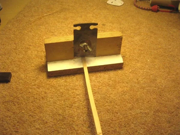

Binding thicknesser. When cutting and shaping bindings it's important to get the thickess almost bang on before bending and glueing on to the body. I'ts not easy to do this with a thicknesser planer or a block plane as these are often very thin and fragile. This little too allows toy to take off a very fine shaving until it's just right. The blade is mounted in a groove bolted on and the gap at the bottom can be set very accurately. When sharp it will produce an incredibly even and clean cut.

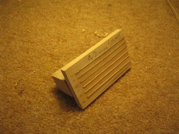

Nut marking gauge.
Getting the right string spacing on a nut is critical to a good setup. It's also amazing how much variety you find in the width of nuts. I have made up tons of these all with different string spacings. The important thing to make sure of is that the string spacing is equal in that the gap between strings is the same not the string centres.
They are just strings carefull spaced and glued to a block with the desired string spacing. To use it you mark and cut the start of the bass E string on the nut and use that as a reference and carefully file the start of the rest of the strings. It's not meant to be a nut file just a tool to mark the position. There isn't a substitute for good nut files.
You can get good results with the next little tool.

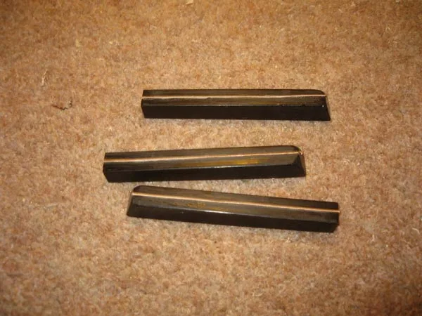

Nut cleaning files.
Very often you need to check or reclean a string slot without cutting it with a nut file. The best way to do it is with a piece of wound string fixed to a block of wood. In a pinch you can cut a nut slot with these but they are not ideal. Ideally the slot needs to be a little wider than the string so if you do try use strings of a slighty heavier gauge. These ones are made from old piano keys and the strings are set into the key with about half exposed. I have loads of them in different gauges. Handy when your tinkering with setups.
