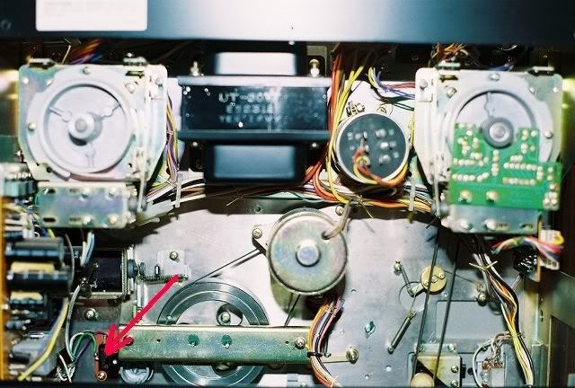

i think you've hit on the problem.
looks like something is broken off in the bottom right corner of the case.
also there are the two spots where things might have been connected?
Reply With Quote

Yes, the bottom of the switch is broken, there are two switches mounted, are both messed up or ?
Make a jumper on each switch between the two connections for a temporary solution until you got the deck checked out properly.

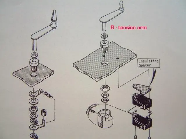

Here is a picture showing the complete switch assembly

The black plastic assembly is a switch, make a jumper between the two spades on top.

After looking at your picture, the white wire need to be solder to the brown wire spade

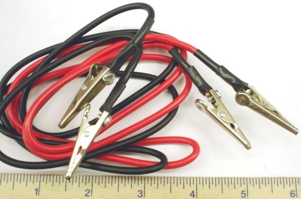

or you can use a jumper by alligator clips if you want:
