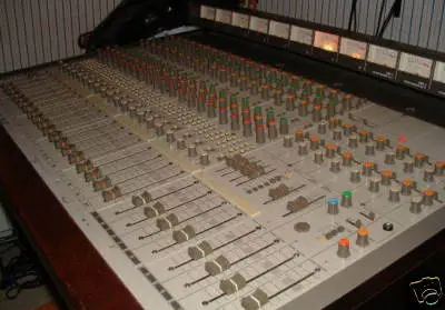

I was immediately going to pick up that Frankenstein (TEAC) board, (1 hour drive time away), but admitted to sweetbeats that I'd not have the time or tech savvy to resurrect it, considering my many other unfinished tech projects that have been sitting around maybe for years,.... aaaggghhhh. My tech skillz and efforts have fallen way off in the last 5 years.
I don't know exactly how an M520 would jive with your setup and stated goals, but it's a pretty nice board. It's a fair deal for $400, fully working. I'd just get it and forge ahead. It's 20-inputs and 8-buss with 16 tape return channels. Seems it was optimized and designed concurrently with the MS-16 tape deck in mind.
It's a nice sounding, well equipped and very flexible board. Hard to equal with today's offerings, but YMMV.

Where is the Tape return section? I see its a split monitor but I only see 8 faders on the right hand section.

The Monitor section is the 2 rows of 8 Orange/White knobs (Gain/Pan) above the 8 Pgm (Master) faders. Toggle (switch) Monitor channels between Tape/Off/Buss.

Yeah. Its cool. The TAPE IN jacks live on the back of channels 1 ~ 16, and you can access them in any combination of three ways:
  • switching the channel 1 ~ 16 source switches to TAPE (has its own TRIM knob)
  • switching the aforementioned monitor section (orange and white knobs) source switches to TAPE
  • switching either the AUX 1/2 source and/or the AUX 3/4 source switches to TAPE per channel 1 ~ 16.
Lotsa options.
