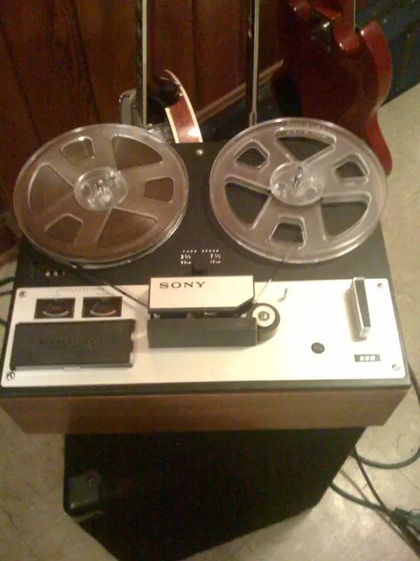

i recently purchased the following reel-to-reel from a friend, and it sounds really great when recording directly into it (via RCA cords). Here's a shot of it:
edit: n00bz can't link files. www . hackberryrecords . com / photo.jpg
So lets say I was going to build a studio around this machine, and then look to upgrade the reel-to-reel to a 1" tape deck later on, possibly an Otari?
I've obviously got a lot to choose from in the form of mixers, and I would prefer to keep this a completely analog affair-- however, if it is just a no-brainer to go digital, I've got a Powerbook that would do the trick. I would like to stay away from that, though. Just personal preference.
Anyone had any experience with this machine? Anyone have any suggestions for a mixer that would work well with it?

Well, as I'm sure you know, that's a 2-track machine, so you're pretty much limited to one-take recordings with that or using it to mix down to.
Regarding mixers for that machine, you don't need much, because you only have two tracks. But if you're planning to upgrade to maybe an 8-track at some point, I'd look into maybe 12- or 16-channel recording boards to allow yourself some room to grow.
The Tascam M series would be good to start with, such as the M-216, M1516, M2516, M520, etc.
I found an M-216 locally on craigslist for $100 that works great.

Yup, as famous beagle already pointed out, you won't be able to multitrack, overdub etc.. on this machine but it's at least a good intro to the world of analogue.
I think this recorder has 3 heads and if that's the case, you might be able to use it as a tape echo device or as a mix-down deck. As far as building your studio around it, depends what you're after and what your needs are.
For example, if you pick up a mixer with 8 mic inputs, you can set it all up and actually record a band or yourself playing / singing but..... it's a 'live' take with no room for errors, as this is only a 2 track machine [actually 1/4 track] with no overdub capability, again, as famous beagle stated earlier.
It's a good starter unit, to get a feel for tape based recording but you should upgrade to something that you can playback and add to previous tracks, something suited more to studio recording.
Look locally for a 4 - 8 track or 16, again, depending what your needs are. If you're a one man band, play all the stuff yourself, then you'll be fine with an 8 track - in fact, most people will be fine with an 8 track unit. In fact, many a time, 4 - 8 track units are plentiful, cheap and will get the job done. You should look for one. Stick to TEAC or TASCAM. They're abundant, parts are available, people know them and it'll be more likely you'll find a low millage unit.
