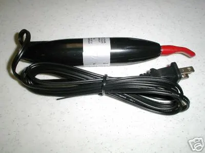

No...

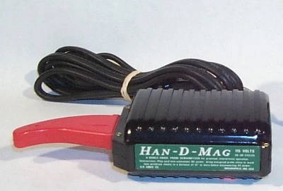

Yes.....

Thanks for the advice on de-magnetizers Sweetbeats!
It's been duly noted.
