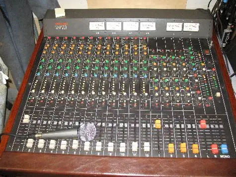

I'd like to help, but somebody is going to have to lead me to a hi-res pic of the top panel of a 300-series mixer...

phantom?
What kind of Mic? This board does not have phantom (M308b does phantom).
Turn on mixer
Plug dynamic min into channel 1 XLR
30 dB pad off (out)
mic trim fully clockwise
line off (button out)
EQ off (button out)
Select buss 1 (button in)
Select L-R (button in)
Pan counter clockwise (L)
channel on (button in, led lit)
No red lights anywhere on board
Ch 1 fader to "8" (White)
Buss 1 fader to 8 (Orange)
L fader to 8 (Red)
Turn mic on if it had an on/off switch
Talk into mic
Observe Meter 1/5 and L movement and possably some red peak led's
regards, Ethan

Here is a photo...
