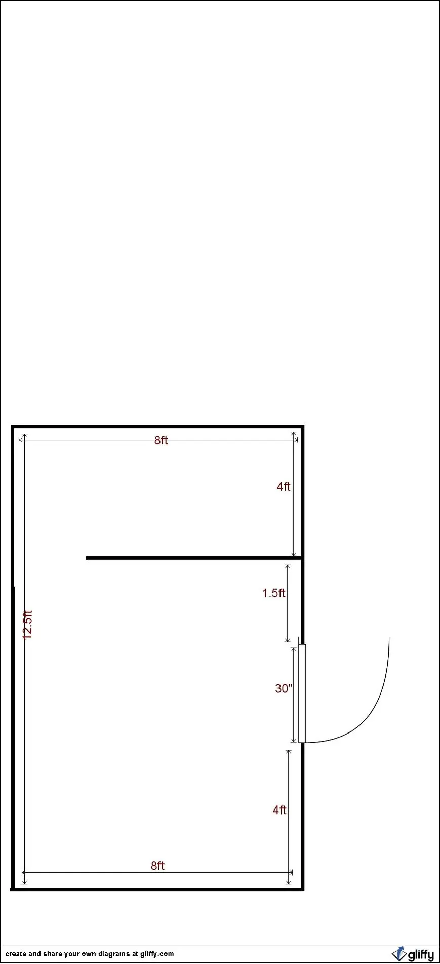

Hey everyone, I just recently purchased a house and have been planning on getting a little project studio built in the basement. Unfortunately its not going to be huge but I have to make it work. The size of the room is 8' x 12.5'. The previous owner had built what looked to be a spare bedroom there and did a horrible walling job so I tore it all down. Hopefully I attached the picture right but that is basically the layout as it is right now. There is still a partial wall in the middle.
The plan for the studio is to make beats and record some local artists. I dont know about a vocal booth at this point but I would like to have one some day.
I am going to be documenting my progress as we get it done. I would like to invite and ask for knowledgeable people to give me some pointers on building in a basement and some soundproofing advice would be great. I have researched tons of stuff but I always like to hear it in English. Thanks again and I will posting some pics of what it looks like soon.

Ya the previous owner had made the walls with paneling. I tore down the paneling and there were signs of moisture so all the walling system is coming down and being redone. I planned on doing a double wall system on 2 sides. Oh I guess I should have stated that the left wall and top wall in that picture are concrete brick. So I planned on doing a double wall on the 2 sides that are not and then drywalling those 2 sides and leaving the others exposed. I am trying to eliminate the moisture in the basement and will be sealing the exposed walls to try and prevent it as much as possible.

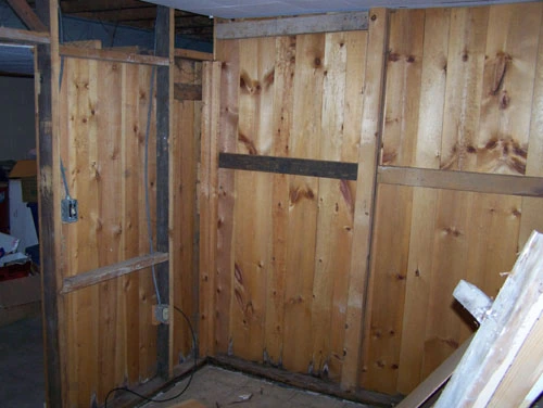

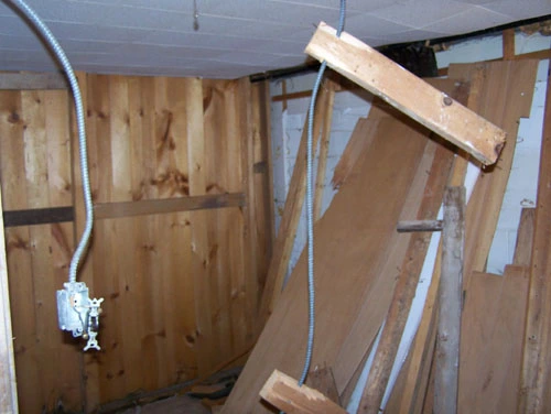

Hey everyone, its been a while since I updated this but im back at it. Work has been crazy.
So here is some updates. The attached pictures show I got all the old paneling off the walls. Though still laying around in there because I have yet to haul it out. My main goal this last weekend was to get it all down though. After taking down the paneling I wanted to examine the existing wall that was there. Well its sort of a wall. It looked like it was thrown together with wood laying around the house and very poorly done. It isnt as bad as I predicted so im just going to add some support to the existing wall and build a new wall right in front of it. My plan was for a double wall there anyway so it may help a bit. I planned on putting in a vocal booth on one side but have now opted against it as there is already lack of space. It may come later but for now I will concentrate on soundproofing and treatments.
It wasnt as bad as I initially thought it would be but I have some work ahead of me. Stay tuned.
