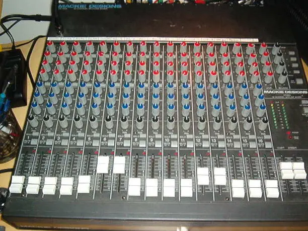

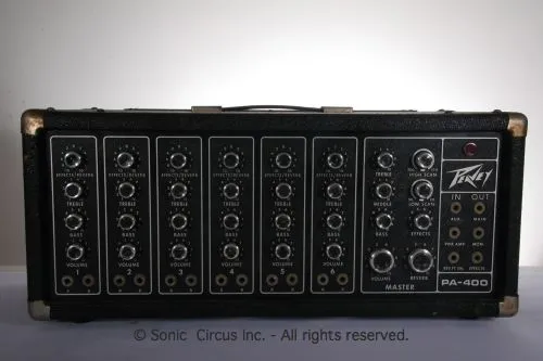

maybe a pic or two??
It's been so long since I've done any live stuff I just don't want to steer my kid wrong.
Out of the L/R on the back of the Mackie...
In to 1 and 2 on the Peavey.
Seem right?

That pa 400 was not what I was thinking it was, but as long as the mackie is not a powered board you still should be fine. You won't have any way to pan things , but maybe thats not a concern for your live app.
You could just send a mono signal to ch 1 on the 400 and still have 5 more channels to use on the 400 giving you 21 channels in all.

Quote:
Seem right?
Not knowing what type and range the inputs on the Peavey are, the universal rule you'll want to look at is keeping decent gain staging. Preferably you'll want to go into 'line level' inputs from the Mackie, and hopefully there will be a way to trim the sensitivity down on the inputs to keep from clipping them -looks like there could just be the volume channel volume control on the Peavey and that is it's volume/input trim one and the same.
Some of those all-in-one boxes have lower than normal 'line level' headroom though, in which case the 'cure to keep from clipping will be to pull the Mackie's master output down and raise the Peavey's master to compensate.

bigtom..." but as long as the mackie is not a powered board you still should be fine. "
Pretty sure the Mackie isn't powered. At least what I've read. The mono input doesn't sound like a bad idea.
Mixsit...the Mackie has input trims on the back of each channel. That should work out good then.
I'll show him what you guys are talkin about and let him go with it then.
No, I meant the inputs to the Peavey, that's where you need to make it right. You run the Mackie with the same consideration- Each piece in the line must be set up for it's own good gaing staging. If that happens to be a mismatch at the Peavey's input, then pull the Mackie master down.
