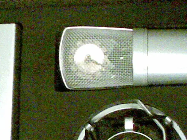

Just a short thread about my recent mods to an MXL 9000.
First and foremost, I took the 1000pf capacitor out and replaced it with a mylar 630V one. The original was a 10V on a junction that sees 135V!
Second, I ripped out the inner layers of the grille.
3, I took out the capsule and replaced it with an Oktava MK319 capsule.
Tube at the moment is stock, but I have a Mullard to slap in there or a Groove Tubes tube.
So anyway I fired it up and I was IMMEDIATELY floored.
The mic is dark in a chocolate kind of way. But not overly dark just a little touch of cocoa on the vocal side of things. Hardly if AT ALL sibilant. Rotating the mic just 10 degrees eliminated ANY sibilance. Has a very immediate proximity effect but not overdone. A very quiet mic. BTW this was done with just an Behringer ADA8000 preamp, so I'm certain it would sound ALOT better on one of my really good pres. Should be dope on overheads.
The tube is an easy mod to do, so I'm guess it should improve with a better tube.
The last step for me will be the cheapo transformer in there. I contacted Jensen and they already recommended a replacement.
I'm about to contact Edcor just to see if they have anything comparable. I know they are significantly cheaper but I'm just exploring my options at the moment. Although I do know that the recommended Jensen is supposed to be galaxies better so its in the front running right now as my choice unless Edcor can convince me otherwise.
I hope to give you guys some sound clips soon.

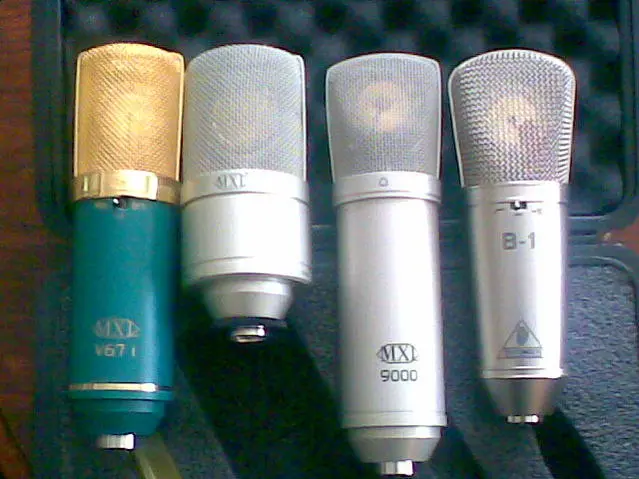

For now here's a few pictures taken on my camera phone of the mics I've modded and the MXL 9000 upclose.
The mics from left to right is an MXL V67i with the extra grille removed only, the rest is stock. An MXL 990 with extra grille removed, the Gus mod and a Peluso CEK12 capsule installed. An MXL 9000 with the extra grille removed, upgraded 1000pf capacitor and an Oktava MK319 capsule. The last mic is a Behringer B1, extra grille removed and a MXL V67/V76t capsule. The Behringer has WIMA caps, no need to upgrade those folks.
Peace
