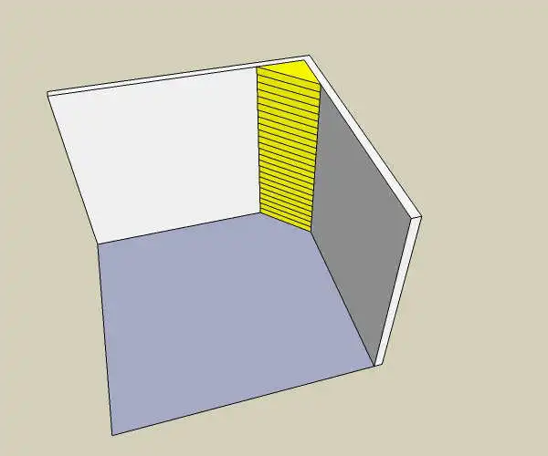

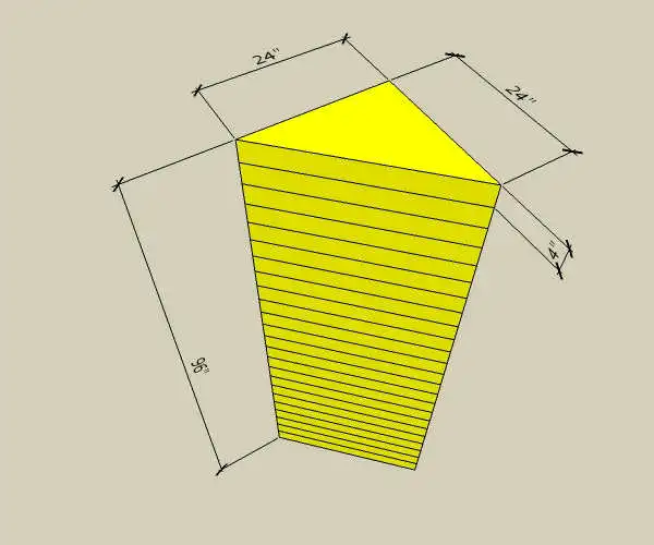

Quote:
Just wondering what areas would you guys recommend treating first when treating a room? ie: corners first,
I'd go with either "superchunks" in the corners, or panels straddled across the corners first. If panels, you should use 4" thick Owens Corning 703 or equivalent. However, if your budget can handle it, personally I'd shoot for the superchunks. For a floor to cieling(standard 8') superchunk, it takes six, 4" thick, 2'x4' panels, cut in half, and then each half cut in a diagonal and stacked. There are many ways to cover these. It just depends on what you want the finished product to look like. Anyway, here is a superchunk.
You can use them at Wall/Wall corners as well as Wall/Cieling corners.
fitZ

Was just gonna use 4" 703 panels for the corners, although I would love to slap those super chunk absorbers. My studio is a common space in my house so I can't do to much to it.
