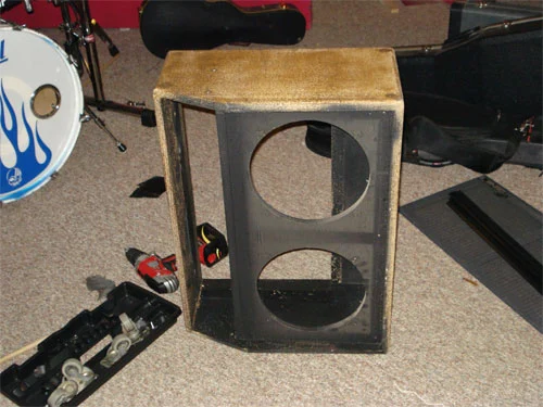

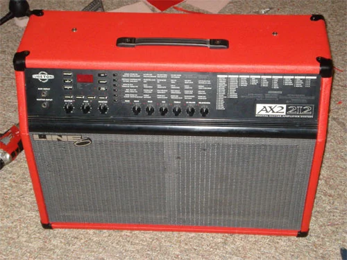

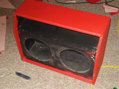

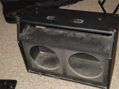

Here are some pics from my Line 6 AX2 212 retolexing DIY.
I started off by removing all of the old tolex which came off quite easily.
Then I sanded down my amps wood (without the speakers and electronics)
I cut the length of the tolex. Slapped on some tile glue and carefully glued the new tolex into place.
Next, I painted all of the old corners and hardware.
Aftering drying time of 24 hours I replaced everything and Whola...New amp.
