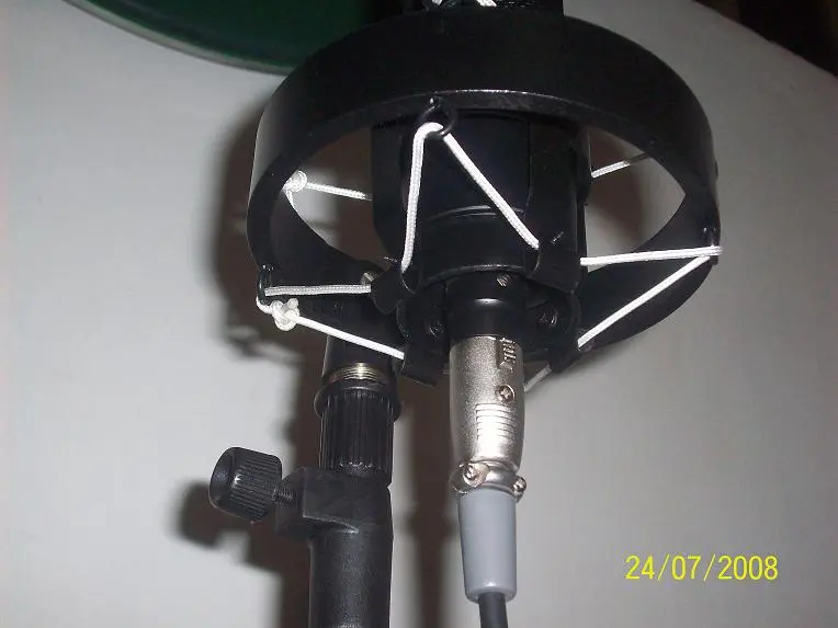

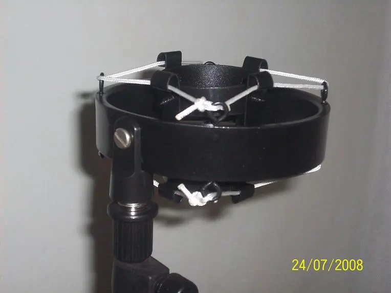

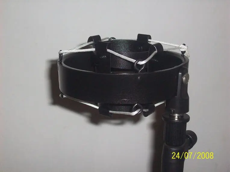

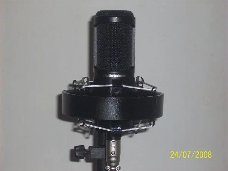

Since in my country there are no shockmounts available for my Audio Technica AT2020 condenser mic, I decided to make one myself.
It came out cheap, and very sturdy.
I'll let the pics do the talking.
Cheers!

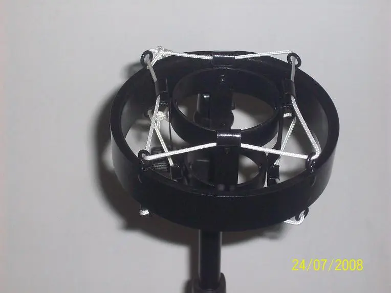

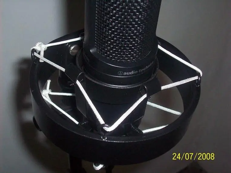

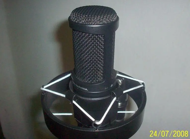

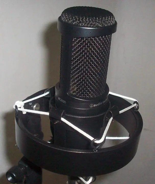

Here are some more

I can't take credit for something that's not mine, I took this design from a guy named Tim O'Brien, and changed it a bit to suit my mic.
Basically I used these materials:
1 4" PVC cap
8 small eyelets
- braided nylon fishing line
8 small drywall screws
1 mic clip base
4 aluminum (or some alloy) strips. I took these from the back of an old PC casing I had lying around.
1 1/2" piece of 2" PVC piping
1 1/2" piece of 1 1/2" PVC piping
Here's a link to Tim's webpage so you can see basically how I did it (with a twist of course) http://home.hiwaay.net/~tjobrien/shockmount.html
So kudos to Tim
Thanks again guys!
Cheers!
