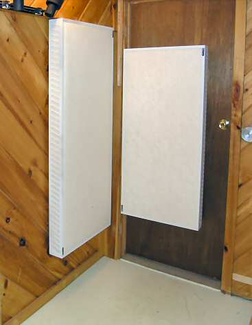

Quote:
Originally Posted by Yonce N Mild View Post
I can't really place anything in the front corners because of the doors.
Sure you can, here's how:
--Ethan

Quote:
--Ethan
Would that be more effective than a 6 inch by 6 inch box running floor to celing. Kind of like this but made out of the rockboard?
What about front and back wall celing corners ? Is the corner fill method effective there? or is the method of spanning the corner more effective because of the airgap behind?
Would it still work well with a 1ft wide piece of rockboard instead of a 2ft piece?
In my drawing the box on the left side of the room is actually a chimney it's not brick it is covered in plaster. That creates 2 extra corners in the room. Should I think about treating them?
Yes, because acoustic treatment is all about surface coverage and thickness. Six inches is thick enough, but it's way too narrow to do anything useful at bass frequencies.
--Ethan
