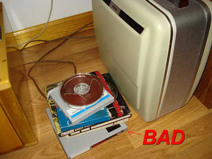

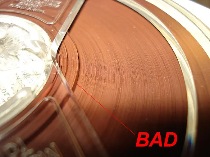

Let me add some visuals in a bad-good style

Before storing the tape "PLAY IT BACK" instead of rewinding, to avoid the BAD as shown.
See pictures:

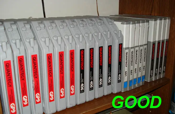

Then put the reel in the plastic bag and in the box and store the boxes like holy books of prophets on the bookshelf (good), but not like a pile of junk-mail under the desk (bad),
and , well, try to avoid magnetic fields and extreme weather as much as possible :
