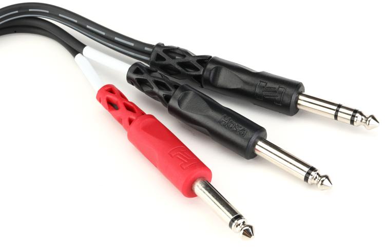

That will work, thanks! However, is there a way i can use insert cables so I'm not taking up 2 ins AND two out on the digi? The mizer i use as a front end recently crapped out, so now ins and outs are at a premium.
Here's the cables I have:
(one trs to two ts)

Quote:
Stereo compression?
