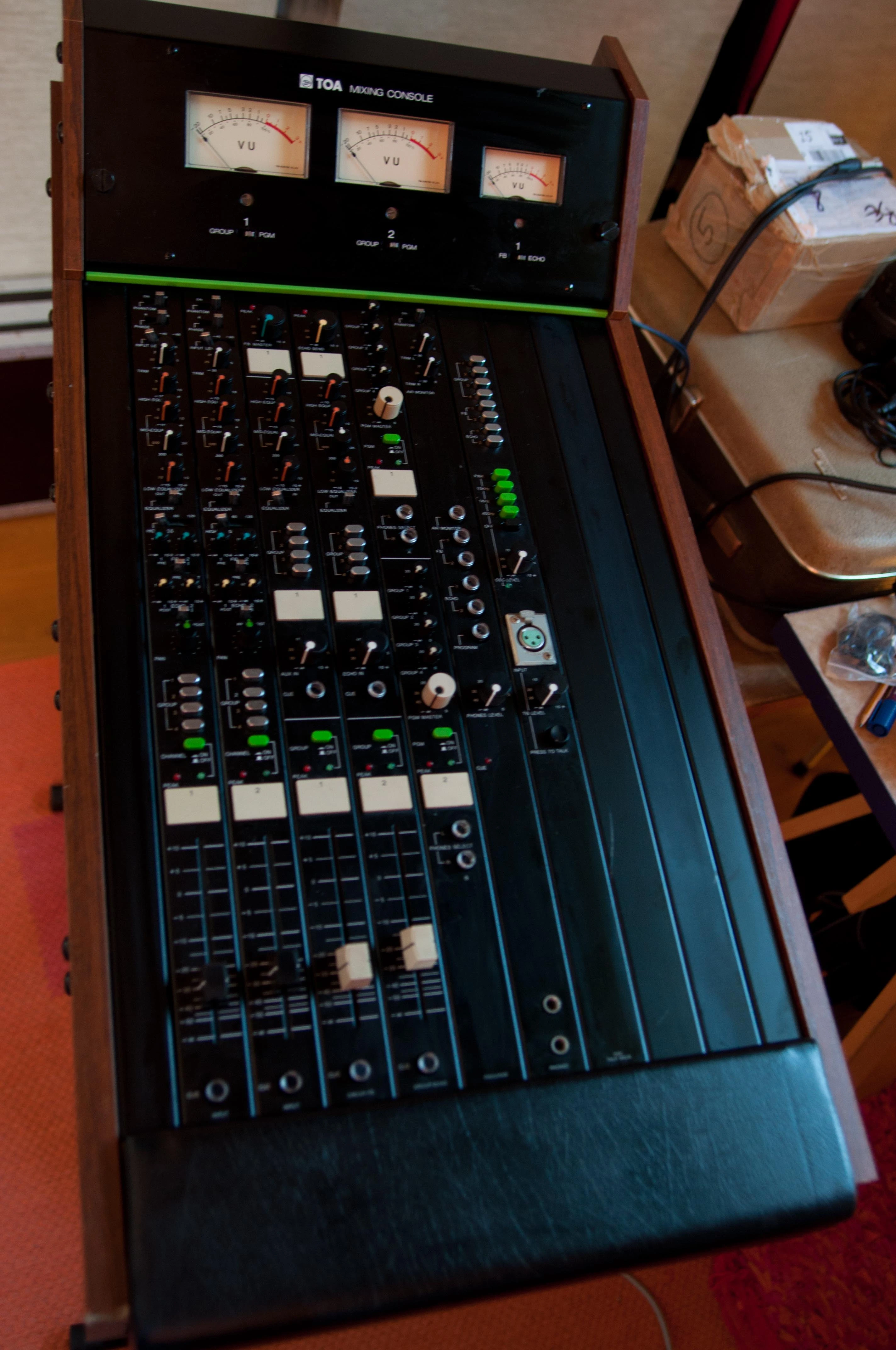

Here's Old Rex as of now - notice the purdy LEDs. Those are the completed modules. It helps me keep track of which are finished
Recently, I have obtained a Hakko desoldering gun. It FREAKING ROCKS! I can do this to a channel in under 15 mins now....
As compared to 2 hours or so.
And the ugly beasties just fall out of their holes afterward. Here they are on their way to the trash can... (notice clumps of old solder)
If anybody here is into DIY fuzzboxes you may have a use for the opamps I'm removing. JRC4558DX. I believe these are popular for some distortion units. I am able to remove these things without damaging them now with my new tool. During the process they barely even get warm to the touch because it is so quick.
I'm sure they are still good so if you need some of these vintage chips shoot me an IM. Free to a good home...

Thanks man! Not only am I swapping parts and modifying circuits but also disassembling everything and thoroughly cleaning all the gunk out. For it's age I would have imagined it to be much dirtier than it is...
After a nice bath of warm water and dish soap the top panels of each module are scoured clean of residues and marker ink. They come out looking brand new.
I still need to devise a good way of cleaning the knobs. They are troublesome. I'm thinking of putting them in nylon laundry bags and putting them in the dishwasher set to for cool cycle.
I finally decided to order some GainBloak DOAs (search Prodigy). The PCBs are here and now I am waiting for components again. I like that they can be built as 3 variations of the Bloak design. I want to try the FET input variant on mic inputs and the BJT variant on the output drivers.

Current stats on this project:
6 of 8 Program modules completed.
4 of 4 Group module completed.
10 of 32 Input modules completed.
2 of 2 Echo channels completed.
2 of 2 Aux channels completed.
Power Supply completely rebuilt and functioning even better than anticipated.
4 of 14 Meters re-lamped.
There's still a ways to go yet. But things are easier now do to new tools, on-hand parts inventory and established workflow.
I have enough of the machine running that I can actually do music projects on it again.
Almost forgot: Parts count for replaced parts per input module is...
50 resistors
28 capacitors
5 ICs
Not bad compared to the master section modules which were roughly twice as much components in the same space.
Also, I am making progress on wiring up the patchbays for this console. All balanced in and outs in the master section can now be patched to anything in my racks and the firewire interface. My DBX 162SL is patched normaled as buss compressor for groups 1 & 2. I wanted to do the same with the Triple C for groups 3 & 4 but that unit doesn't bypass signal when turned off
I love having all Aux and Echo sends and returns in the patchbay. So easy to set up any chain of outboard gear now. All FX devices output into a small submixer too which I can patch into the returns. In the event I want the FX output of a device separate I can use the direct out for it on the submixer.
For a live sound console it easily adapts to a recording environment with some simple patching.
