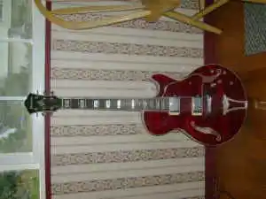

Recently aquired an Ibanez Artcore. llooks like an AF75 but the body is a deep red quilted color (mahogany?).

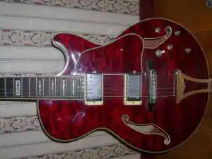

As you might have detected in the picture the tone and volume knobs are missing. I figure black is the "correct" color but the generic ones we got from GC don't slip far enough down and the big gold knurled ones don't look right with the rest of the hardware chrome. Should a store be able to order the correct part from Ibanez without it costing a ridiculous amount of money? Other choices/suggestions.
This is the first guitar my son has had with a floating bridge. We're told that makes it harder to tune which seems to be the case. Or does this just indicate the bridge needs to be adjusted?
With only a couple of days worth of playing (maybe 8 hours tops) the smallest string (E string?) has broken twice. Is this another indication the bridge needs to be set-up correctly? The strings that were on it when I got it were decent looking but no telling for sure how old or how much play they had. They were replaced with D'Addario Phosphor Bronze lights. I know those are generally thought of as acoustic strings but they sound great and the light strings let him play more as he's still building up strength and calouses.
The idea of replacing a full set of strings every couple of hours of playing time until we sort this out isn't to appealing. It would be nice to just be able to replace the one string but it looks like individual strings are available only for the larger gauges. That seems wierd to me. Wouldn't the smaller diameter strings tend to break at least as much if not more often? Oh, as another "data point" he thinks he might have been trying to tune the string too high; like a whole octive If that's the case then I guess it's lucky just the string broke
The output from the pickups sounds pretty good. In fact our crappy amp sounds pretty good when this is plugged into it But I'm wondering, does anyone mic a hollow body or use a combo line out and mic?

first ...... any decent music store is gonna have individual strings. There's no need to replace the set and since you're talking about the plain E, it's not necessary to get the same brand or even acoustic or electric.
Second ...... that guitar is meant to be strung with electric strings. For using into an amp you will get a much better sound with electrics.
And electric strings are lighter gauge than acoustic strings in most cases.
A floating bridge isn't inherently more prone to going out of tune however, you need to understand that it goes in a very specific spot to be in correct intonation. If you don't have a good handle on this .... find a tech .... have him place the bridge and then mark it. Also, change 1 string at a time so you won't let the bridge fall off and thus, out of position.
Adjusting the bridge shouldn't have any effect on whether you break strings or not but it's not impossible that there is a burr or sharp edge on the bridge saddle causing it.
But that small E can also be prone to breaking even under normal use. A student can easily break one by simply picking way hard. Again, a tech should be able to figure out which it is.
These are all pretty basic issues and any competent tech should be able to sort it out easily. Just find a store with a good rep that's been around a while and trust them to have chosen an at least competent tech.
