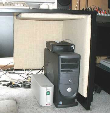

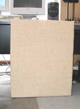

or build something like this:
(it's just rigid fiberglass/absorbent material wrapped in fabric...it can help reduce the noise)

as far as moving the mics further away from the computer, the problem is that my basement is an open design, so there really still won't be any barriers to stop sound from reaching the other end of my basement, which is why i was hoping for some details on some kind of sound reducing box. that fibreglass example seems really interesting. is there anywhere on the internet i can find plans on how to build one? how well do they work?
can't comment on how well it will work, but it will reduce it some...and for cheap.
And it's extremely easy to make. Just buy a few panels of 703 (here's some places to buy), wrap 'em in fabric and mount them around your computer
You just want to be careful with the build up of heat...those fans need circulation.

My computer overheats too easily for that kind of configuration. It's actually so bad that I have to keep one side-panel of the case off or it gets pretty hot. That just makes it even more noisier.
www.atsacoustics.com has good pre-built panels for cheap, but shipping is what you'll be paying for mostly, maybe not-so much on the smaller, 2" thick ones.
Just make sure it's an almost air-tight enclosure and that you only use it while tracking, and keep track of the temperature. You won't want to leave it in there for long at all since it will overheat.
Also, replacing the power supply and fans with quiet ones will help even more, in addition to moving it as far away as possible from your microphones.
