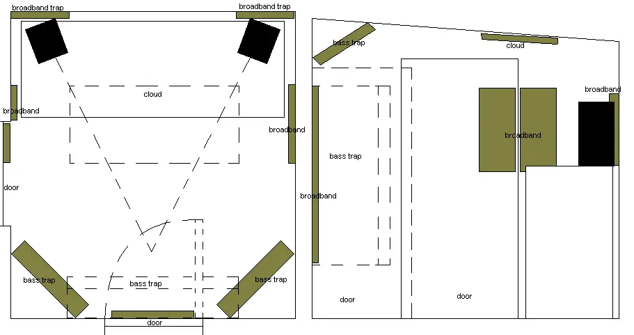

I finally bought some rigid fiberglass today (£40+vat for 20 4'x2'x2" 45kg/m knauf rocksilk), and I'm quite happy and excited that I'm in the final stages of construction(just doors to hang, and panels to make).
Anyway, my mum was in B&Q earlier, and brought me a leaflet of energy efficient products, including insulation. I had a flick through and came across Breathe Natural hemp insulation. It's 1200mm x 375mm x 75mm, and 35kg/m. 8 for £27, so dearer than the rocksilk and less material, but it's better for you and the environment.
How do you think this stuff will compete with the rocksilk? It's less dense, but so is bonded logic ultratouch. I've emailed asking for absorption coefficients.
Also, I have Alesis M1 active MkIIs, and am wondering if i will suffer the same sbir effects as monitors with rear ports? What thickness is best to treat sbir? And is it just directly behind the monitors that need treatment?
Would this be ok(hope you can understand it)?
