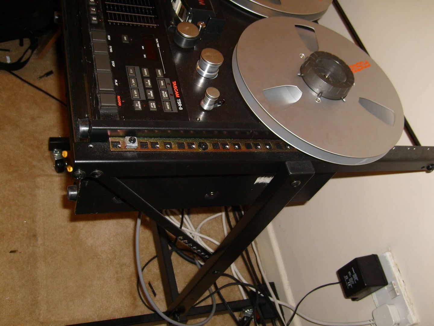

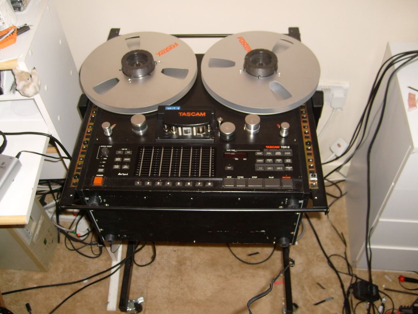

Here's one of my rackmounted machines. As you can see, these aren't the official TASCAM rack-ears - I had no intention of paying $80 for two pieces of bent metal. I'll probably spraypaint them one of these days.
http://i89.photobucket.com/albums/k2...e/S7300119.jpg
http://i89.photobucket.com/albums/k2...e/S7300120.jpg
http://i89.photobucket.com/albums/k2...e/S7300121.jpg

Quote:
nice setup Jean-Pierre! thanks for these pics. I like the koala.
looks like a flip-system from vertical to horizontal and back... usefull enough.
err, but how did you mount these "two pieces of bent metal" with the TSR? did you take advantage of the existing screws, something like that?

Quote:
I took one of the plastic ears off the side of the machine and used it to mark where the three holes should be on the rack strips. Like the Soundcraft ears I used before (I have two TSR-8s) they don't line up with the three holes in the machine, so I had to drill new ones (in the strip, not the deck, obviously!).
Then, when I'd cleaned up the holes so they were flat and free of debris, I put the plastic ears back on the machine and used the original three screws to fix the rack strips on. This does mean that the screws aren't going in quite as deeply as they did before, but there are six of them and my other machine has been happy like that for about 2 years now.
