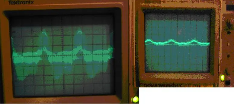

mjhamil came over and brought a scope with him.
He scoped the speaker outs on the two channels and we found a big difference between channels. Channel 1 is a smooth small compact wave line whereas channel 2 has a wave that extends way beyond the norm. He took a few digital photos which he will give to the music store/repair tech so they can see the problem.
The trick was to use the keyboard (Middle C) and just strike the note. The waves in the attached pictures are from the keyboard note. You can see the width of the distorted channel is way different. The noise/distortion is also clearly audible over the speakers.
We did try a test signal CD using 50Hz and 2K. The noise was not audible on the speakers, but the wave was still distorted (being consistent still had that wider range of noise).
mjhamil thinks it could be in the pre-amp. We didn't open it up because that would void the warranty. So it's back to the shop tomorrow with the pictures....

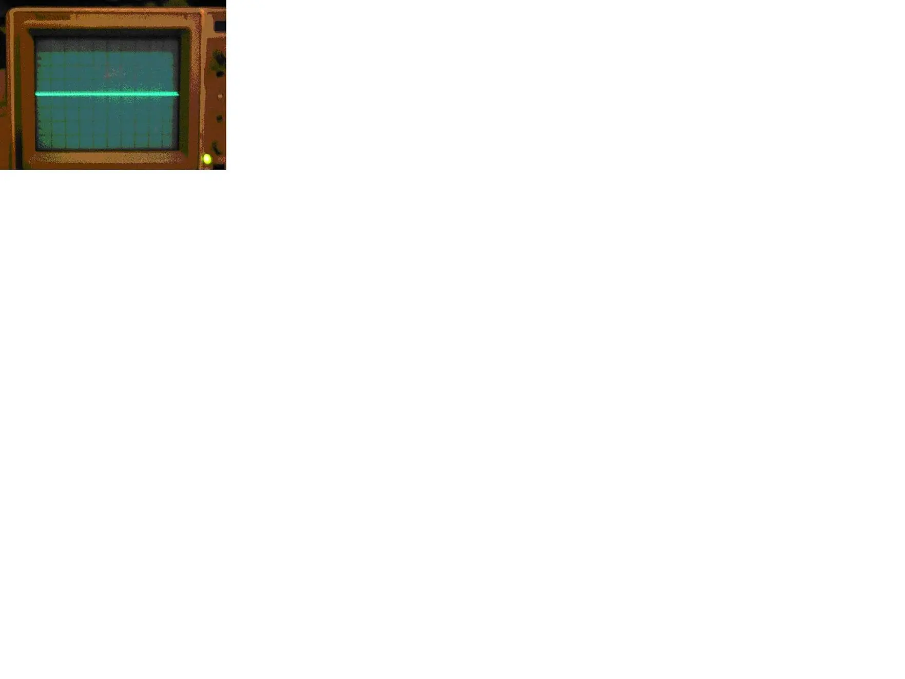

Quote:
Originally Posted by dementedchord View Post
that amp is oscilating... does it do it with nothing connected???? may be a pre-amp isssue...
When there's nothing connected the scope is a flat line. Here's a pic of the scope at "ground" as mjhamil advises. mjhamil said it was probably pre-ammp related. It's a week before they can look at it, so I'm told. Using my GK for a power amp in the interim - it works but it's not great....
