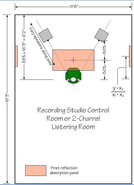

most I read say not to use the Eq to flatten the room. I never quite understood it, other than its a phase thing or something. and the fact all the actives use an Eq, even hi end monitors have the eq switches? so I may never understand that.
but don't eq the room with a er....eq.
you may not be able to exactly match the numbers but it gives you a idea of a sound layout...harhar
read Ethan's web page on some basics. my favorite is this one
