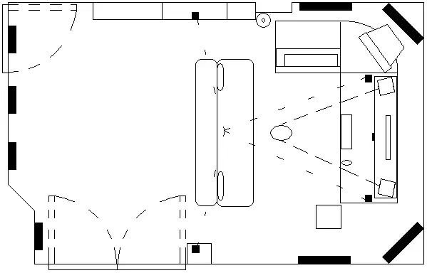

Quote:
Originally Posted by Foo-bu View Post
I finally got the time to put together some sound absorbers to control my room. So far they've been doing a pretty good job. I think i've done a decent job of positioning them but if there's any suggestions, i'm all ears
You've got none in your first reflection points, or your corners, which means they could be a whole lot better. You've also got loads of space on your left, but a wall on your right, which means you won't have a very good stereo image. You want to have your mixing position center along the shortest wall. Also, set your speakers up vertically...
You're gear/place(how I'd love to have that room) looks nice, and you did have me salivate over it. I just though the acoustics could be improved.

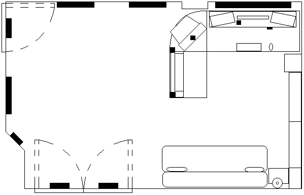

So I've drawn roughly what you have now, and then what I think you could do to improve it:

wow thanks for those sketches. they're pretty much my room exactly. They offer very good suggestions that i didn't even consider before.
A question though... with the room as you have drawn, is there an optimum way for the instruments to face while recording them? I'm a drummer so I often have my kit facing the double doors (which is why I have the baffles on the back of the doors and the wall behind them to kill off reflections.
Also, I didn't take a picture of it but i guess its something to condsider when tracking or mixing but I also have a mobile baffle that is twice the size of the big ones i have on the walls now. I was thinking that in the current position i have all my stuff in, I could place it behind my keyboard to make a box around the kit....not quite sure if this would help. and since the baffles on the wall are just hanging off of screws i was thinking of taking off a baffle when mixing and placing it above my couch where its at now so thati'd have absorbtion behind and in front of my speakers.......would any of this even help?
I'm just trying to figure out my alternatives
Thanks for the suggestions though i'm going to have to play around with them

Well you want to first treat the bass(corners), then the side(and ceiling) first reflection points, then the back wall.
I don't think it matters much where you face, as the sound goes in all directions. You could put the large panel infront of the double doors, or on the wall opposite them(when tracking). The sofa should absorb a bit too. Btw what's behind the double doors? If it's a closet open the doors when tracking and the clothes should absorb well, and have the large panel across from it. Then face either the back wall, or the mixing position. As long as you stay away from a corner, anything should be fine though.
Absorption behind the speakers is not a priority. You're better off treating the corners and first reflection points(incl. back wall) before you treat behind the speakers, imo.

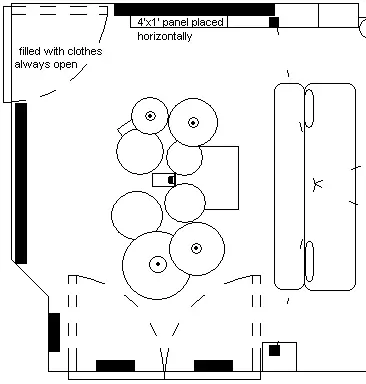

keep the ideas coming
btw, the bookshelf doesn't come apart :P
It is cool to have a closet in the room. Is there close in it or is it empty? If empty fill it with clothes or something soft. Then put an absorber on the inside of each door. When recording drums open the closet up with the doors angled out from the wall abit. Set your drumset up facing out of the closet. The closet will absorb reflection going back into the mics. You could get a couple of office deviders or make some bigger free standing absorbers and put them around your drums for more isolation. Like this little diagram I did.
You may have to angle the drums a little different because of the wall on the one side. But this is just an idea.

Hoops that offers almost no isolation. I don't really think isolation is needed.
This is my suggestion:

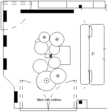

the double doors actually lead to a wide open basement which is actually quite noisey due to a furnace and open staircase leading upstairs to a very yappy dog.
The small door however is a closet full of a bunch of clothes and other shelves and junk.

Maybe this then:

Quote:
I wasn't suggesting it for isolation but for if the room is to reflective. But seeing it is a doorway to a room not a closet then that won't work.
