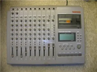

The 488(std) records up to 4 tracks simultaneously, and has only 2 mic preamps.

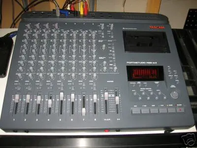

The 488mkII records up to 4 tracks simultaneously, and has 4 mic preamps, including 2 XLR inputs w/phantom power. The 488mkII has other upgrades to the 488(std), which makes it a distinctly better machine.
Yes, they are both fun machines.

Arrow If you want to use 4 mics simultaneously to 4 tracks
on the 488(std), you might be well suited to get a stereo mic preamp w/phantom power, as the 488(std) has only 2 mic inputs w/preamps & no phantom.
