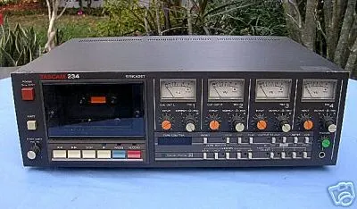

Arrow Heck,...
I'd fix the 244 and get the 234! Heheh.
