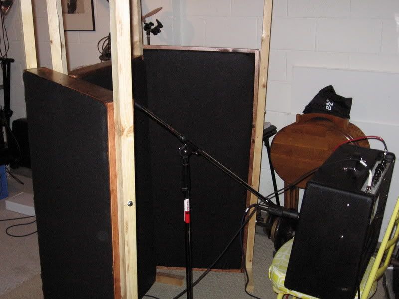

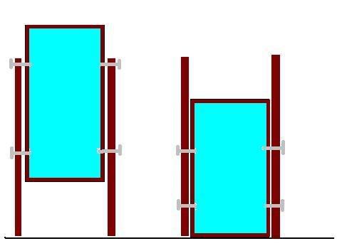

As promised, here's a pic. They can be used as room treatment, or as gobos as needed. Frames made with 1x pine, glued and pocket screwed together, stained and poly'd. Since they are moved around a lot, the frames help keep them intact. If they were permanently on the wall, I'd probably go frameless. Some have plywood backs, others are felt on both sides.
I put 2 T-Nuts in each side, to attach the legs with a bolt. Finger tight is fine, so I don't need a wrench. There are two leg positions - the lower one showed here, and one where they are about 6'6" high, perfect for vocals, and drum OH's. The crappy stands are just crappy pine. There is a 3/4" dowel glued into the feet, allowing them to pivot in the legs. This comes in handy for a quick vocal booth config - you can spin the feet relative to the legs, so two of them can be right next to one another at an angle.
Also, the feet are easily seperated from the legs for transport. With a 12 pack of 2" 703, I made 4 4" thick, and 4 2" thick. Oh and they work really well.

Quote:
How much did the total come to after making that setup? I've been wanting something like that for awhile.
Reply With Quote
Thanks Andy, for the info and the photo. I am well-armed enough, now, to put something nice together for myself.
