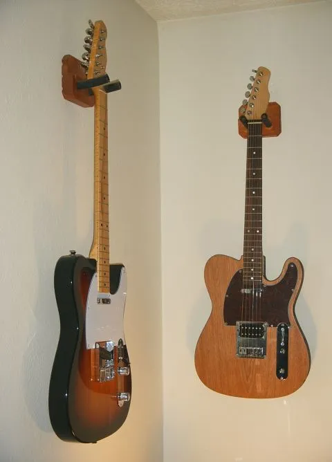

I built a tele
The body is built from some poplar that was leftover from a job that I did a few months ago. The top is mahogany veneer. The sides and back are black. The neck is a mystery neck that I bought on ebay. It turned out to be pretty nice. 12" rad 1-5/8ths nut Strat style rout. The tuners, neck plate, output jack, control cover, and the alnico tele neck pickup are all MM. Noname humbucker bridge, with a noname paf spec pu. Tortoise pickguard. This is my first build so I tried to keep it simple and use it as a learning experience. So far so good.
I fit it together last night for the first time so I could drill all of the holes before completing the finish, shielding, wiring etc.. I'm having trouble making myself take it apart.

Awesome work! I take it you've not gotten to play it yet? I'm wondering how the intonation will be.
Way to go!

Thanks man. After it got the fresh set of walmart 10's. I wired up the humbucker, and plugged in through my volume pedal. Crude but effective.
I was anxious to see how well my layout worked. I wanted to get the best angle from the back of the intonation blocks to the holes through the bridge. Everything worked out fine. The neck height is right where I want it. I didn't have to touch the truss rod. Intonation was easy.

That's amazing. When you mentione "mystery neck" I figured you'd be fooling with the angle and depth till the cows came home.
Good for you!

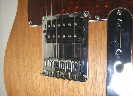

If you have a 4 conductor Humbucker in there you might get a push/pull tone or volume pot and try either coil tapping for the single coil/humbucking sounds or series/parallel wiring. Also a 4 way switch adds variety to the sounds as well. I modded a couple Teles I built and I think the series/parallel sounds are my favorites. The Tele in my signature has the coil tap setup for now-its got some kool tones.

I'm not sure how I'll wire it yet It's a two wire pickup that I have in it now, but that could always change. I ordered concentric pots so I could have separate volume, and tone controls. If I wanted to split the pup I don't know where I'd put the switch.
From what I can tell it's going to sound great. It plays dreamy.

The Push/pull pots are in the tone or vol. pots-there is a double pole/double throw switch in there that lets you wire it up without any extra swithes or holes drilled in the control plate. See my link for the push/pull pots~

Thanks man. I'm familiar With push pull pots, but they're not an option with concentric pots. I bought stuff to wire it up in a few different configs. I've definatly given thought to a split coil setup. I guess I could always drill another hole in the control cover.

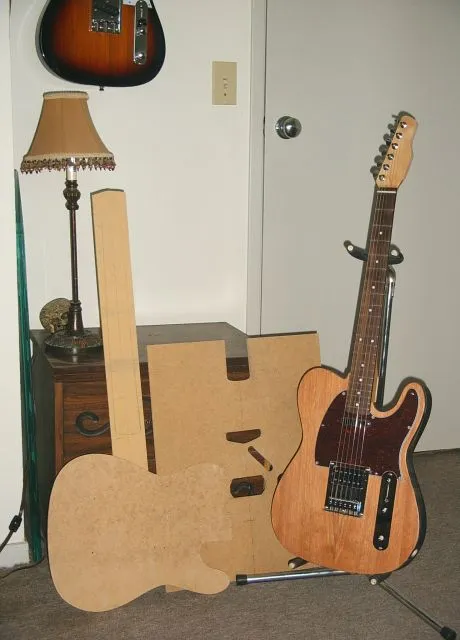

Thanks everyone. I've got it taken apart now for the shielding, finish etc. I hope to have it back together this weekend. Here's a picture with the templates that I made. I started gathering parts for it about a month ago, but only started on the build last week.
